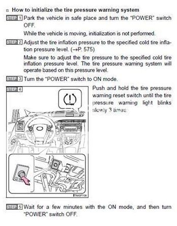

    It's only used for the fan system because compared to the currents that the traction battery deals with, its effect would be negligible. Same deal with the trickle while charging idea. While the car's in ready mode the traction battery keeps the 12V battery very happy indeed. The reason why you read so many 12V battery concerns is because it's a small battery and its degradation goes unnoticed until things get weird. Since it doesn't crank the engine there aren't any warning signs in advance of its demise. Years to go before you have to worry about that, though.
    Regarding the TPMS, all you'll see of it is a little tire shaped warning light when you're powering up. It's only set up to warn you when a tire drops below a range of acceptable pressure. Read your owner's manual.
    Here's what's in my owner's manual:

    FIRST OF ALL, you are AMAZING for that diagram! Second, yes, the vibration problem has been fixed. They took the car in the shop for 1 week, lent me another Prius for the meantime, and then I got it back a week or so ago. They said something was not factory setup properly and the stock tires were no good. So I just nodded and signed the paper saying "Covered Under Warranty." And I was on my way and happy! I was so stressed for 2 months trying to get my issue resolved, but glad it's over, I love my Prius, and I defend it's environmental, driving, and other features to the death with facts. Thank you for your post, and I've heard hysterical (probably not at the time), but funny stories about the 12V batteries. I just figured maybe the Panels could charge the battery under the seats, but if not, that's fine, I didn't buy a solar car, it's a Hybrid, I'll expect more out of my next car, which I plan on being Electric. :)
