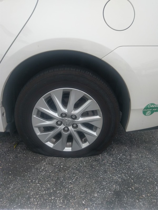

    Same thing happened to the wife this past weekend while driving her 2012 PIP
    When she was leaving work, she noticed that the car felt a bit funny (I'm surprised she actually could feel the difference, normally she has zero clue how the car feels/handles/even looks). She got on the freeway and immediately another driver in a pickup honked at her and pointed at her car. She pulled off and found the tire was flat.
    Apparently she had picked up a giant nail. America's Tire told her the nailhead was almost the size of a penny. I had her fill up the tire to 50 psi at the gas station she pulled into so she could limp it to the tire shop a mile away. As she was filling it up, she told me she could hear air coming out.
    What's odd was there was zero warning from the TPMS. We're the second owner, car has been serviced exclusively at the Toyota dealership all of it's life.
    Tire could not be patched - driven too long and destroyed the sidewall. Also, the nail was near the shoulder and would have been dangerous to patch. I'm still puzzled as to why the TPMS light did not go off.
    You can see by the picture my wife took that the tire pressure is low, to say the least...
  20. wjtracy
    wjtracy Senior Member
    Sep 19, 2006
    11,374
    3,609
    Northern VA (NoVA)
    Did they use the old TPMS in the replacement tire, or give you a new TPMS?
    If it is a quick blow-out, I guess you could squash the TPMS pretty fast, breaking it. Otherwise it ought to react with a couple minutes. If it gets broke in the flat, possibly it does not have time to transmit the zero pressure reading, and the old good reading will be stuck in the data register.
