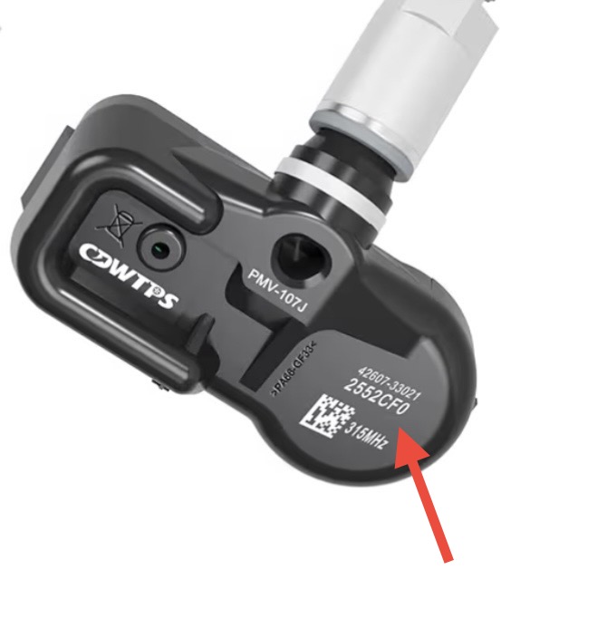

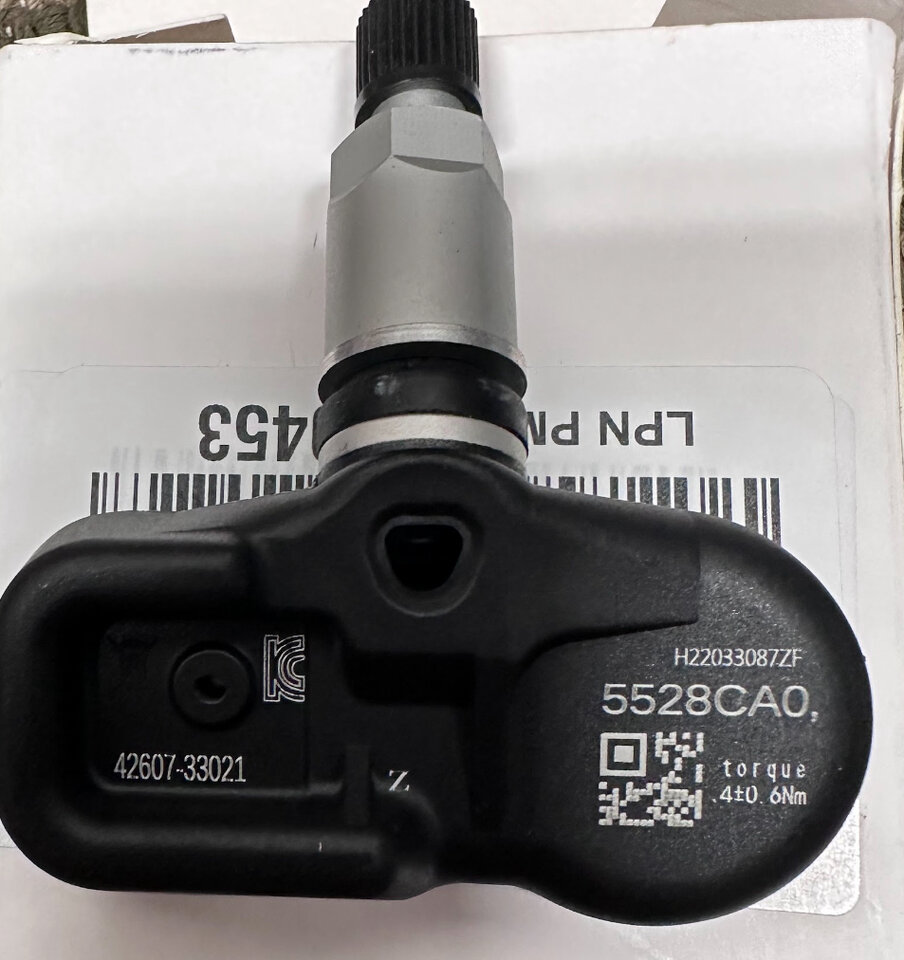

    You just read the id printed on the sensor. Rf readers are only needed if you forget that basic step.
