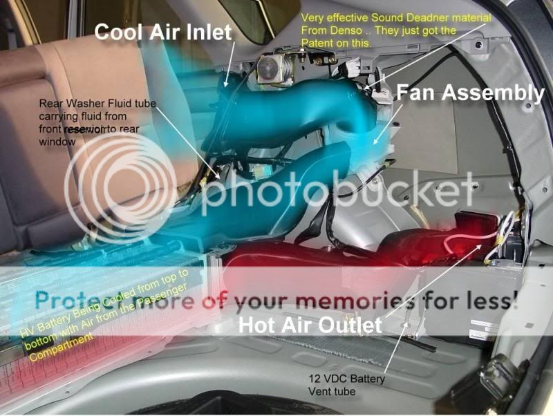

    Yep that's right, and from there it should vent out to somewhere in the wheel well.
    This part is confusing me. The inlet is most definitely in the back seat (upper right side).

    Yes and that is above the wheel well, isn't it?

    Above the wheel well is the fan.
    A clogged fan (credit to Luscious Garage) wouldn't be visible from outside:
    After cleaning:

    On Saturday afternoon i removed and cleaned the cooling fan,it was pretty much clogged up as in the photos by Luscious Garage,i've never heard the fan switch on in the 395,000 km as the temps here in Ireland never get anywhere near those of the US hot states,although if it ever had to come on it might draw air but it was so clogged that the air wouldn't go anywhere.....Glad i read the post!
