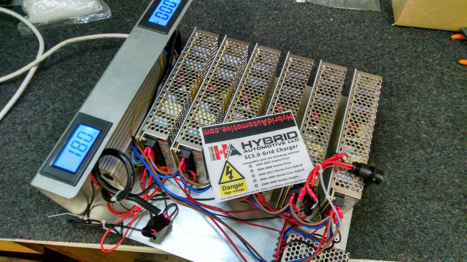

    Using that logic, our soon to be released Patent Pending sub-$650 3A fully programmable charger (with data logging, wireless control, PHEV mode, and some other treats we can't share yet) should be an amazing value that even you would be an advocate of ;-). It will charge a Prius battery from vehicle empty to vehicle full in one hour. Here is a photo of one of the recent design prototypes:

    • Jeff, well, I can see on your photo presumably 6 x 40Volts standard SMPS LED driver boards in series - a solution which was suggested on other forums years ago. How you are going around making grounding there? It is potential electrical hazard.
    • Battery Capacity in Prius is 6.5AH hence claiming charging from empty to full in ONE hour by a 3Amp charger is a miscalculation on your end, dont' you agree?
    • People are asking us what we would recommend them to use. If you beat $1300 USD price tag and make 6amp charger for $600 - we may consider it as an option to recommend. Until then - other options look more attractive. But there is ONE HUGE BUT - we would not recommend charger to be installed in the vehicle like you suggest for the reason below:
    • Important thing to consider when promoting charger to be installed in the vehicle is: "grounding" and high voltage isolation. Your current solution is bypassing fundamental safety feature designed by Toyota - i.e. you are connecting your charger AFTER two safety relays which do cut off both negative and positive battery terminals from the rest of the car - by doing that you are getting High Voltage OUT of the pack even when the vehicle is not in operation. It is highly dangerous and electrically unsafe under normal circumstances, not to mention unfortunate collision from the rear. Assuming the metal body of your charger is grounded (if not and voltage is floated - then you are breaching Electrical Code) - then the High Voltage Negative is present on the car body - which should not be the case, and that is highly unsafe. People who are installing your device may be unaware of that and putting their clients and themselves in danger. How about checking potential between ground of your charger and concrete floor around the car when it is in operation? Or between car body and concrete floor? That could be high enough to give person standing on the concrete in the garage and touching the car an unpleasant tingling.

    Pixie dust! :p Our Electrical Engineer already has this well in hand. Unless you want to sign an NDA, you will have to wait and see like the rest of the fine users of this forum.
    I never said 6.5Ah. Vehicle empty in the case of a Prius is 40% SOC. Vehicle full is 80% SOC. Maybe this will help you understand: 80%-40%=40%*6.5Ah=2.6Ah 2.6Ah/3A*1.1(allowing for 90% CE)=57 minutes and 20 seconds. Sorry I was off in my estimate . . .
    This is where your bias against our products shows most clearly – or perhaps it is just because this is new and unknown technology to you. This is not a bypass of a safety measure of the charger, it is a core design feature of the product. Of course our product will get HV current in and out of the battery while the vehicle is not in operation – that’s how it works! Zero percent of the aftermarket chargers on the market that connect on the other side of the vehicles battery disconnect relays can rebalance the NiMh cells of the traction battery pack. It’s impossible. In order for a charger connected to the other side of the disconnect relays to charge the battery, the car must be in ready mode to close the relay and allow battery charging. When in ready mode, the car will prevent the battery pack from being charged more than 80% SOC. If the battery cannot be charged over 80% SOC, the cells cannot be rebalanced.
    That is why our charger is connected to the battery side and is used with the vehicle off. Otherwise it would not work. This is also why the charger is “slow” as you put it. It’s intentional, charging the pack above the normal operating range with anything other than a very low current AND proper battery cooling would badly damage the cells. Whether you believe it or not, every aspect of our products has been fully thought out and carefully calculated. Our customers deserve nothing less.
    And this is why we have built safety measures into each one of our car harnesses. Each harness has either a diode or fuse to protect the circuit in the event of a collision. Even if you were to hack at the harness with a knife or dip it in a cup of water, the worst thing that would happen would be a blown fuse and some water dripping on your upholstery.
    My Electrical Engineer is concerned based on your comments you don’t understand our product and the basics of the design well enough to publicly opine so strongly against it. I think I agree with him. It’s a shame you purport to know so much about our products and would disparage them so openly yet you repeatedly make inaccurate assumptions about the very basis of their design. The HV circuit is fully isolated from the vehicle chassis – high side and low side. Connecting HV ground to the chassis would be an extremely unwise idea.
    We at Hybrid Automotive take our customers safety very seriously. Years of R&D by us and by others that have contributed to the basics of the design have been performed. All of our charger power supplies and metal cases are earth grounded, as they should be. All power supplies that we use are quality name brand units that are fully isolated. All chargers have internal fuses on the HV circuit. All HV wiring is aircraft grade and rated well above the voltages seen. All HV wires are wrapped in high strength PET sleeve to prevent against abrasion. All car harnesses feature high voltage isolation via either a diode or fuse.
    We have sold over 700 of our charger systems in the last 24 months and others have built thousands more. The design has been more than thoroughly vetted. We’ve tried to be patient and address your concerns, even when they seem disingenuous to us. We’ve spent enough time on you. You don’t know our product well enough to voice a valid opinion of its safety or effectiveness. We are done with you. Have a nice day :)

    The number of sold devices is worrying - that is how many potentially hasardous installations are out there.
    I thought you yourself designed that charger and was poiting at some worrying matters expectig you would address those concerns. Unfortunately you did not. First you claim your charger does de-sulfation (no such thing in NiMH) now you are saying that "diode or fuse" provide High Voltage isolation. That is not even funny. Does not look like you know much about electronics, battery chemistry and safety. Hope you have someone nearby who would provide an expert advice.
    Could you please ask your engineer simple questions and enlighten us with the answers:
    - Is High Voltage output internally isolated from the AC mains by a transformer?
    - Is High Voltage output negative line in your charger is floating or grounded?
    Those are two simple questions power supply manufacturers have to disclose because of the electrical safety regulations.
    Common design found in Swithed Mode Power Supplies (SMPS) is that isolation transformer is used and output negative is grounded (e.g. PC Power Supply AT/ATX units found in any desktop computer which can be modified by an experienced engineer into High Voltage charger easily or that LED drivers you shown on another photo).
    If that is the case with your design - use of insulation transformer and HV output negative is grounded - that is not a bad thing at all, BUT installation that charger into the car makes it a hazard. Use it outside the car with the battery pack placed on the insulated material, use PPE and you'll be fine.
