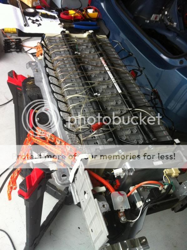

    Below is a picture of my parallel set up. The black wires represent the negative terminals. I connected all the negative on one side and ran a alligator clip to connect to a negative terminal on the other side. As long as all the negatives are making proper contact you should be solid.
    The crazy wires you see going over the top was for the positive terminals. I took a single speaker wire and ran it back and forth over the top. I would strip the wire and loop it once around the positive terminal before running it to the next one. I used the nuts for all the terminals to keep the wire in place. You just have to make sure none of the positives make contact with the negative connections. Double check everything as you are placing the wiring. Wait a few hours and check the voltage of each of your modules. You will notice the voltage will start to equalize with all of the batteries. Mine took about 6 hours.
    A difference of .2 volts was all it took to throw the triangle for my Prius after I put it back together the the first time around (had not balanced the modules then.) The modules must be balanced properly. I would not bother driving the car until you get the modules equalized.

    I'm going to break open the battery pack and look for anything loose. If I don't find anything I'll do 1 discharge/charge cycle on them and try to get the modules in better balance. Maybe I can figure out how to connect them in parallel to get voltage perfect. I'm not convinced my problem is caused by a .2 difference in voltage, but at this point it seems like the next best thing to try.
    If this doesn't work I'll get a better scanner that can give us some real info.
    Here are 2 pics of my setup on the last go 'round. If I don't have to replace any more modules I'll just leave the pack in the car. From the 3rd pic you can see there is enough room to get to everything. Moving the pack in and out of the car is difficult and probably when you are the most vulnerable.
    Is it necessary to remove the bus bars from both sides?

    To even out the voltages on each module you do need to remove all the bus bars.
    Then connect all the positive terminals together and all the negative terminals together. Let the battery sit like this over night, this will equalize all the module voltages, the higher voltage modules effectively charge the lower.
    A voltage difference of .2 volts or more on a pair of modules will throw a code.

    In order to connect it it parallel you will need to remove the bus bar from both sides yes. Just pick up some simple speaker wire to make a harness for wiring parallel. Just remember, positive to positive, and negative to negative.
    When charging/discharging, did you make sure to leave the top and bottom black compression bars installed and tight?
