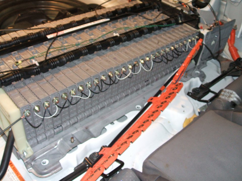

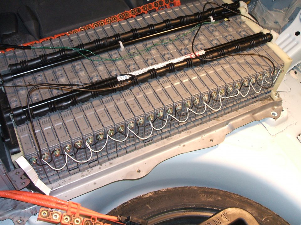

    Baddabing baddabang baddaboom let's see what's happens: DSCF7550.JPG DSCF7551.JPG
  8. ryousideways
    ryousideways Member
    Apr 24, 2013
    35
    101
    Merritt Island, Florida
    Haha Honestly I ran out of speaker wire. I would have done the entire thing the same way if not for my short supply.
    As long as you keep the positives connected to positives and negatives to negatives it should not matter how ugly the set up is.

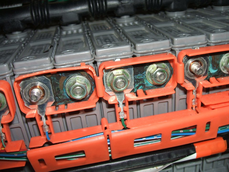

    DSCF7552.JPG I cannot catch a break here. I stripped 2 of the terminals and can't connect the busbars. I really wanted to power up the car when I knew the voltages were all perfectly balanced, but Murphy's Law seems to be in full effect tonight this month.
    Does anyone have any idea what I can do, besides breaking the battery all the way down to work on the threads? I can't get a dye on the terminals without taking the modules out. Maybe some type of self-tapping nut??
    Anyone? Help a brother out here.

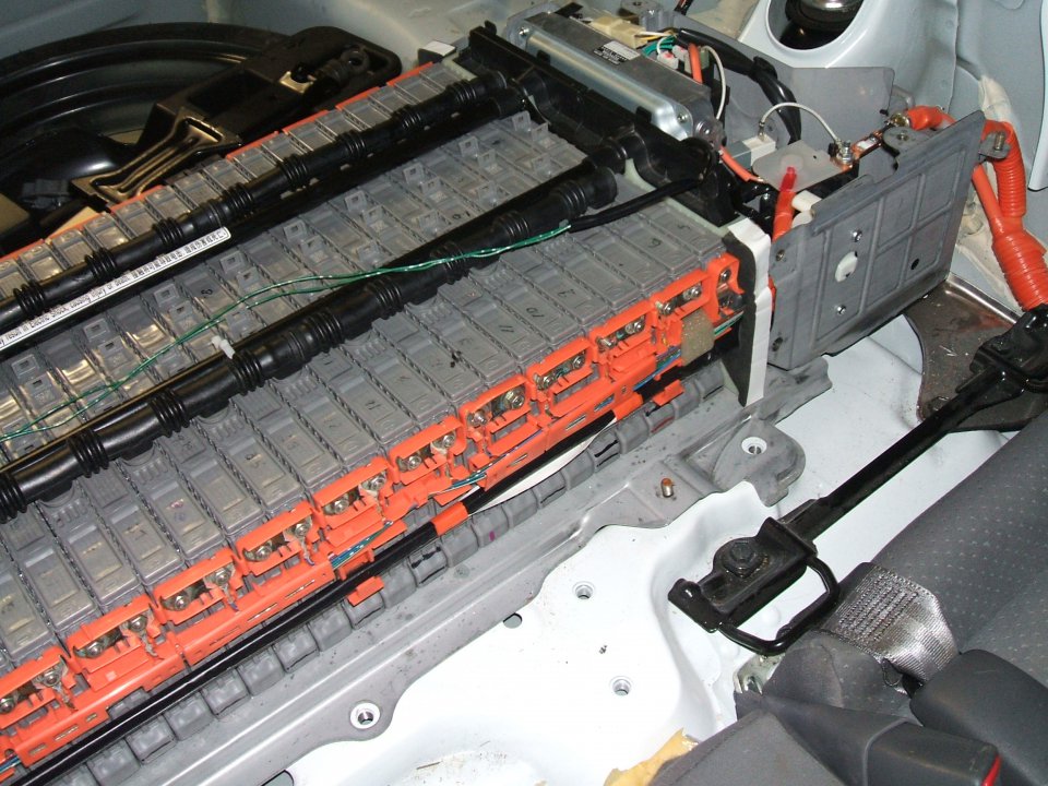

    I got the pack apart and repaired the stripped terminals. The good news is I'm getting must faster at yanking it out of the car and getting it torn apart on the workbench.
    Since it's apart I want to check out my new weakest link and replace if neccesary. Module #1. The original numbers were respectable:
