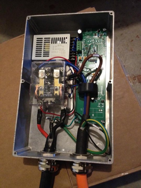

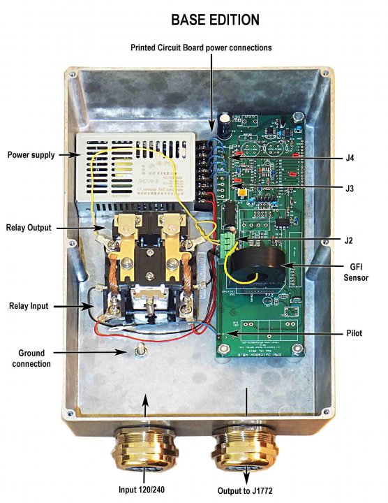

    Well, if you can solder- you can do it.
    IIRC there's 10 solder connections to be made, and some crimps. I soldered my crimps as well- but that's not required.
    I did all the soldering yesterday, and assembled the components last night.
    When I tested it on the Volt (which draws about 3300 watts vs the PIP which draws 2200 watts) nothing was even warm. FWIW- the JuiceBox is rated at 60A / 15kW Level 2 charging so my tiny 3.3kW draw is hardly a load compared to it's 15kW rating.
    Honestly, for the PIP- the EVSE Upgrade for $250 is the best of both worlds, I wouldn't build a JuiceBox for the PIP- but there are PIP owners who prefer a L2 charging station- so for them the JuiceBox at half the price and more than double the capacity of entry level commercial L2 stations is something to consider...
    Here's some photos (not of my build- but mine is identical) from a completed JuiceBox and one without the heavy input and output wires...
