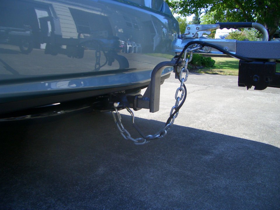

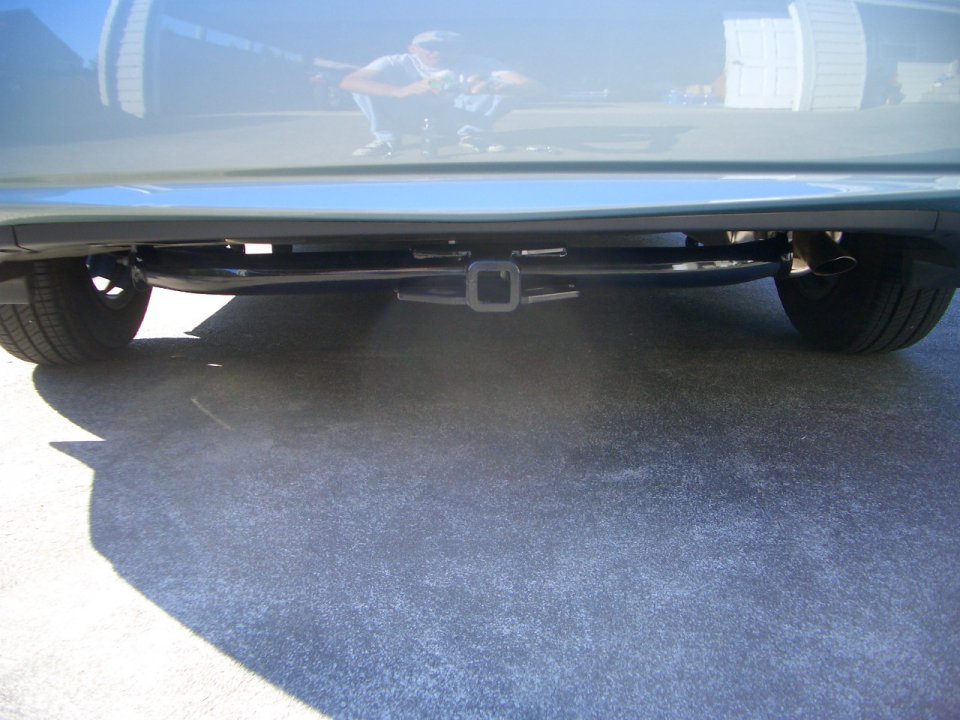

    +1 on the curt 11276. Thats what i have. But if u want one that isn't too visible, get the hidden hitch.

    I have the Kurt, works great love the polished look. Install was easy and straight forward. I have a platform rack and my biggest issue is that i have a 29er and so do my friends, when i drive i swear that the bike is so big the tires cause serious drag out the sides and even the handlebars and seats.

    FYI, Draw-Tite, HiddenHitch, and Reese are all made by the same company (Cequent) and are identical hitches.

    Keep in mind that this is still a Class I hitch.

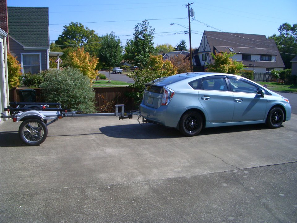

    I saw a landscaper using a Gen 2 Prius pulling a trailer behind with a full sized riding mower, weed eaters, edgers, extention cords, etc on it. I guess the "don't use a hitch" stance is mostly because Toyota knows there will be nut jobs out there who think their Prius is a 1/2 ton truck.

    Go boldly. Costs about 5 mpg. No worries. Not one mention at the dealership when in for service.

    The trickest hidden hitch design I've seen is over at the GM-Volt forum where someone has designed a receiver hitch concealed entirely behind the rear " bumper " assembly. The receiver is accessed through an opening behind a hinged license plate bracket. Very clever. ( and no... a Volt is not " designed " for towing either )
