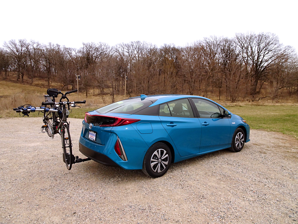

    Mine needed an extender, but worked just fine... which ended up really nice, since I can open the hatch while carrying a load. See:

    If you are still looking, I would recommend
    2017-2020 TOYOTA PRIUS PRIME STEALTH ECOHITCH
    https://torkliftcentral.com/2017-toyota-prius-prime-stealth-ecohitch
    Yes, it is substantially more expensive than others but their quality, design and dimension (2" opening) seem superb.
