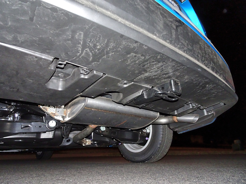

  10. john1701a
    john1701a Prius Guru
    Jan 6, 2004
    12,840
    5,312
    OMG! They weren't kidding when the install difficulty was listed as 10.
    It turned out nice, but that's not a recommendation I can give to anyone unwilling to really get involved. The steps are tedious & numerous. It took me 6 hours. Of course, you could always have an installer put it on.
    Stay tuned for photos.

  11. john1701a
    Jan 6, 2004
    12,840
    5,312
    Here it is:
    Notice how snug up against the bottom of the car it is, with very little actually exposed. That's really nice for minimizing aerodynamic exposure. It prevents ever bumping into it with your leg too; however, it does necessitate the purchase of an extender.

  12. bwilson4web
    29,042
    16,512
    Is this is job where the car should be raised on ramps?
    Do the instructions include wiring if you want to two a small trailer?
    Any significant difference between the Curt and the other?

  13. MikeDee
    MikeDee Senior Member
    May 9, 2013
    1,581
    597
    San Francisco Bay Area
    Extender? I was hoping not. How far is the end of the hitch from the bumper?
    I've got my Draw-Tite hitch, but haven't put it on yet. I was going to jack up the back of the car and put it on jackstands. I have two threaded studs that I will use as locator pins that will help in locating the hitch and bumper.

  14. bwilson4web
    29,042
    16,512
    I was always going to have one because my wife's wheel chair carrier uses a 2" receiver. I'm just hoping there is enough gap for the extender-expander.

  15. john1701a
    Jan 6, 2004
    12,840
    5,312
    Draw-Tite appears to hang down about an inch lower than Curt, allowing a regular accessory to attach just fine.
    My bike-rack has a locking mechanism, so it's too thick to fit underneath. Of course, I wouldn't want to it to be close to the hatch. So, I'd use an extender anyway.

  16. jaymac
    jaymac membore
    Feb 21, 2012
    179
    57
    Oregon ( Umpqua Valley )
    2013 Prius v wagon
    The opening on the receiver of the hitch mounted to our gen 3 lift back is nearly flush with the bumper. Can you get a ball mount with that much extension stock or would that be a custom proposition ?
