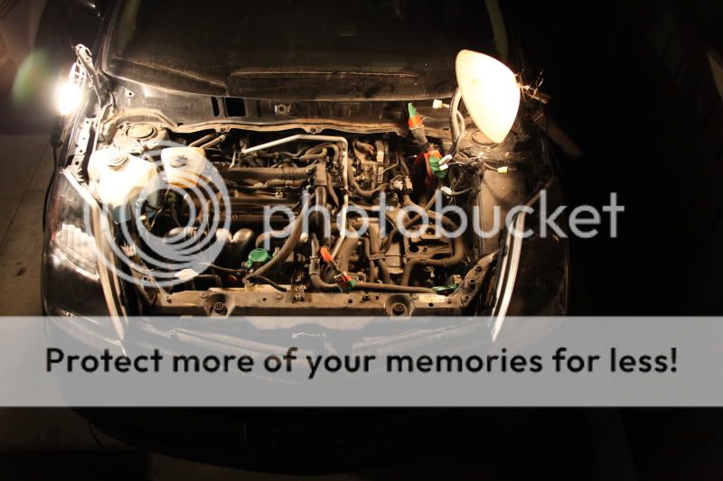

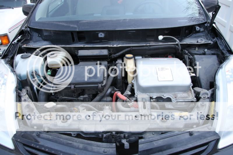

    Update:
    I stopped by the Toyota dealer in Claremont today, picked up the fluids and gaskets I needed. Cost me a little over sixty bucks. Back to Big Bear for the weekend....the transaxle showed up via freight today. It looks good, hopefully it works!

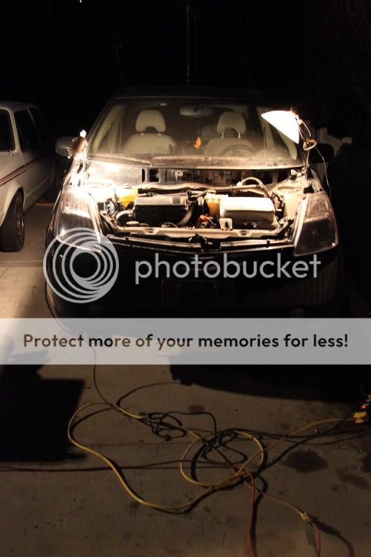

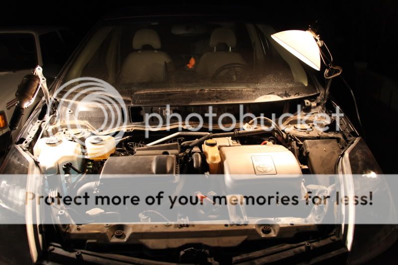

    I started pulling the prius apart tonight. Took the hood, wipers, and wiper motor off.
    It got dark and cold quick....26 degrees Fahrenheit. Out come the lights!

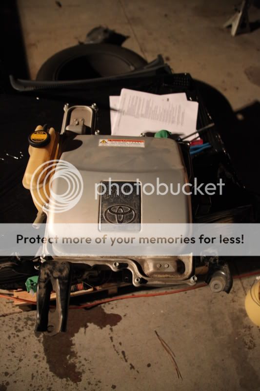

    The inverter is coming out. Simple stuff so far.

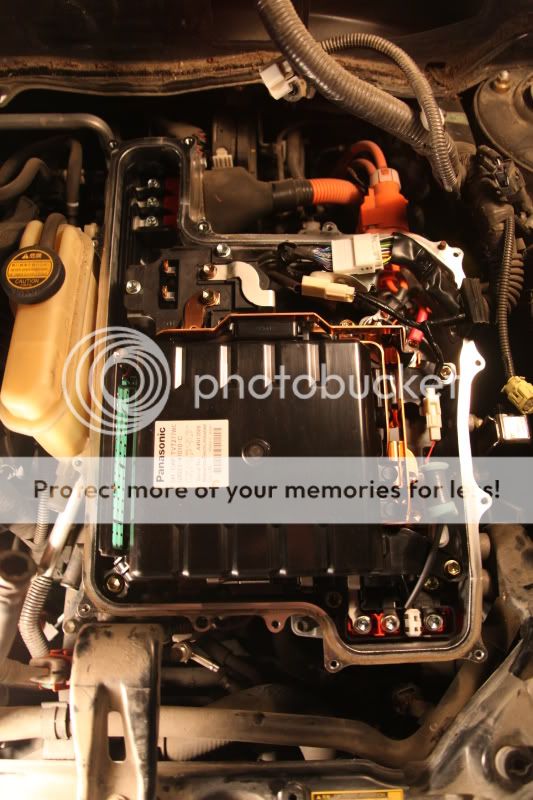

    Inverter is out! It was only three bolts plus the hoses and wiring harnesses. Took me about a half hour!
    A big hole left by the inverter. Now you can see the transaxle.
    Airbox is out.
    Time to quit. 26 is kinda cold with no sun...and I cannot really feel my fingers, or feet anymore.
    I will start first thing tomorrow morning.
    If what I have done so far is any sign of what is ahead then this job is a piece of cake. Pretty simple stuff so far.

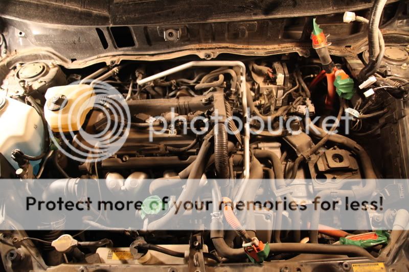

    That's a lot of pipes under the inverter. It is good that you are taking the photos. If you forget what to connect where you can just review the pics.
  14. dailyphotofix
    dailyphotofix Junior Member
    56
    Portland, Oregon
    Yes, lots of coolent hoses, but they are all pre-formed to the spots where they connect, so its really hard to make a mistake or forget where it connects. Same will the electrical connections, they are all different types of connectors, so you do not get mixed up very easily.

    Yeah, it was pretty dirty in there. There was a bit of sand and dirt filling the edges of the inverter top as well, so I had to be very careful to remove it all before taking the top off.
    I have no idea if it was in a dusty area before me. I am guessing so, because I do not think this amount of dirt would come from a concrete jungle.
