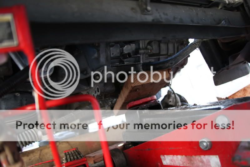

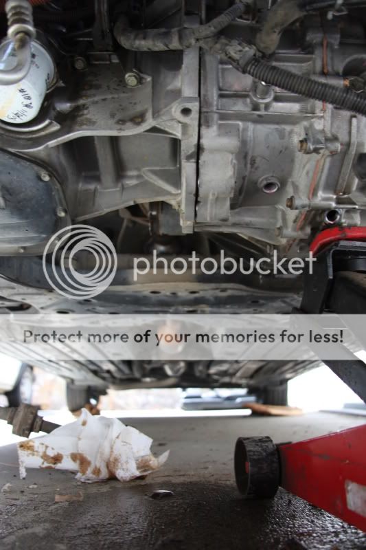

    Update:
    Major progress today!

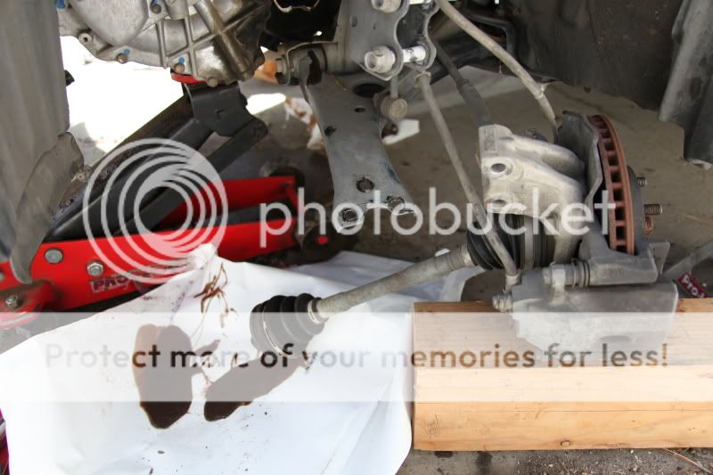

    Axles pulled off. The grease has turned to liquid in the boots.

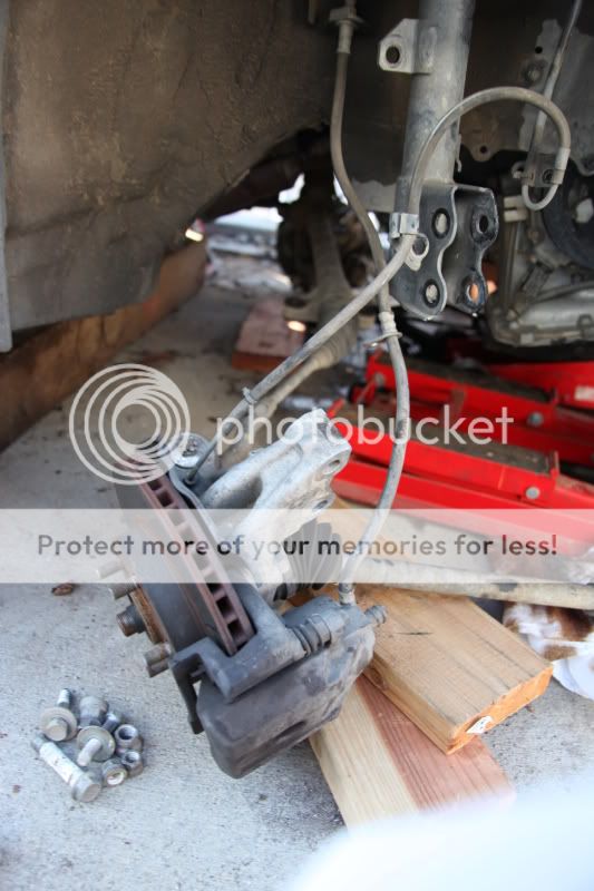

    I just unbolted the brake assembly and set it aside with the axle...much easier than pulling it off the axle as the instructions called for.
    Another drive shaft/axle shot.
    Its coming apart!
    We took the bracket off the top end and it is going down quite smoothly.
    It basically fell off once the bolts were out.

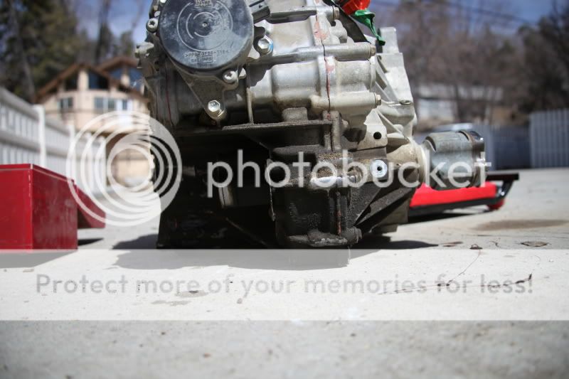

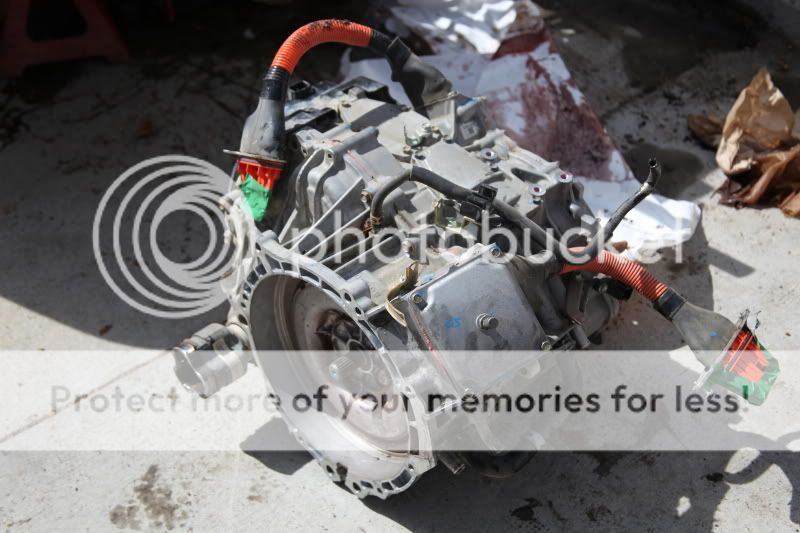

    There it is! Out of the car.
    Its a heavy sucker...

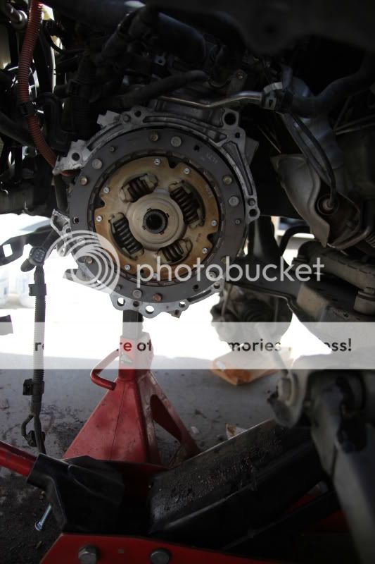

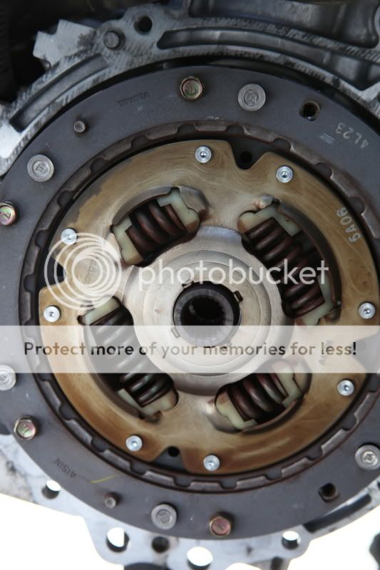

    Torque Limiter/Axle Dampener...whatever you like to call it. Everyone has a different name for it.
    I measured the Dampener and Checked the torque...it all checked out fine, no sight of unusual wear at least that I could see.

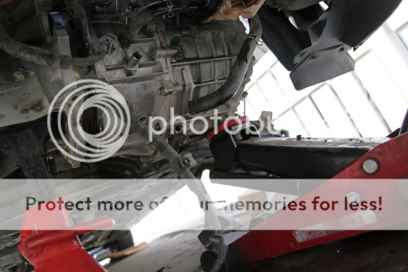

    This is the spot I thought was leaking...

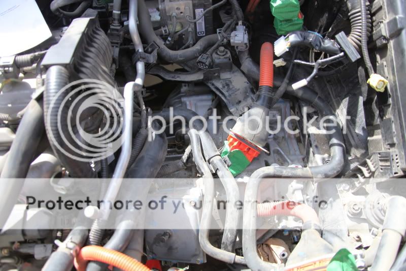

    New Transaxle going in!
    Had to be careful not to stretch the brake lines...
    I pulled the crossmember off to get the transaxle in. The instructions called for it to be pulled in the beginning, but I did not do it at first because I thought it would be a major deal. It ended up only being 4 bolts.
    It was a long day...10 hours. I am beat, but it is almost done!
    Tomorrow I just need to attach the axles (I just picked up new CV grease today) and throw the inverter in and I will be done!
    Not a bad job. Now hopefully it will work!!!

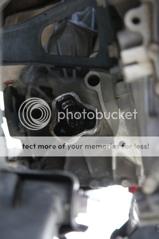

    Looking at this photo, the parking paw motor assembly is larger than I thought it would be:
    So the driver side (vehicle left hand side) seal failed filling the boot with transaxle oil:
    Then normal road dirt mixed with the transaxle oil in the boot and simply passed back into the transaxle when it cooled. With the NHW11, there is a one-way, vent plug that lets the air out when the transaxle heats up. When it cools, the vent closes and having a negative pressure, it would suck in the oil-dirt back in from the boot.
    You might want to check the dimensions of the driver side shaft. The oil/dirt/grit mixture probably worked like a lapping compound with what remained of the shaft seal. Given the likely need for a tight seal, you may want to consider a replacement shaft. For sure, look for any surface imprefections that might have hassened the failure.
    Great work and photos! Thanks!

    The input damper clutch was mentioned early in this thread, and
    there's nothing obviously wrong in your pictures of it. Interestingly,
    yours seems to have plain white plastic spring seats rather than the
    colored ones; compare your IMG_6995.JPG versus this shot from one
    of the training runs [which admittedly is of a Classis transaxle
    instead, maybe the part actually changed in the NHW20]. Can you
    see any "clutch dust" around there that would indicate that it was
    slipping or misbehaving? Normally it's probably supposed to not
    slip at all or only during unusual torque transitions between engine
    and driveline, and it would probably have to be in pretty rough shape
    to trigger severe enough rev mismatches between engine and the MGs
    to throw a code. The surrounding flange from your old transaxle
    seems pretty clean, where if this thing was a real clutch in the
    traditional sense you'd probably have a thick coating of dust there.

    How were your CV boots? Any chance of the proposed dirt ingestion
    having come through the axle seals, which do seem like a fairly
    vulnerable part in the right rough conditions?
