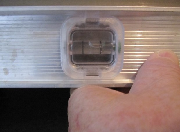

    Sounds good. Only niggle: was the car level when you refilled? Likely not that much difference with slight tilt.

    IMG_1752.JPG View attachment 57478
    I checked my 2007 Prius with a level running along the bottom line of the doors. Have a 4-foot level, so can't just set in on the panel of the open door. Even when sitting on flat ground, this is not exactly level. The rear of vehicle sits higher than front. Probably close enough, you won't over or under fill the transaxle by using this as a measure. I'm sure on the lift under frame at the dealer, it is very close to this.
