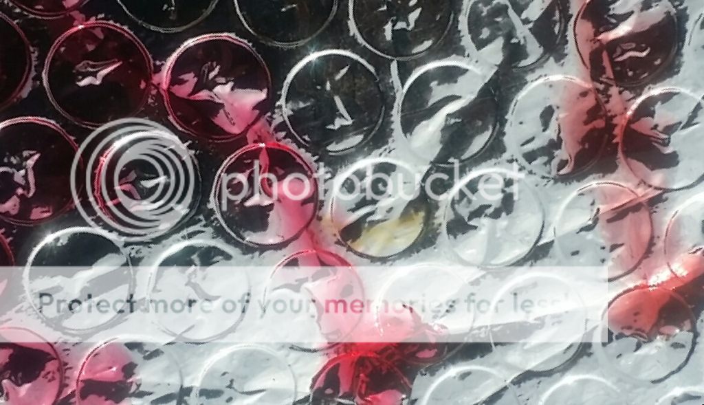

    Ok people keep saying the transaxle needs 4qt. Yeah you gotta buy 4 qts. But it seems to me it's more like 3.5 qts. I pulled out the filler tube and well I had a bunch over my arms trying to put the filler plug back in.
    BTW 30 to 40k change interval might be overkill. I changed it today along with my regular oil change at 168904 on the odometer last time I changed this stuff a bunch of meal came out at 130k odo.
    This time a very few flecks on the bottom of the oil recovery pan after I filled the fluid into the 4 containers. Last time I put 3.8 in had about 0.4 left in 5he container used about 0.2 for a quick rinse. Well compare the fluids after 38k miles[​IMG]
    Wonder if you can guess what's the old stuff sure as heck ain't black
