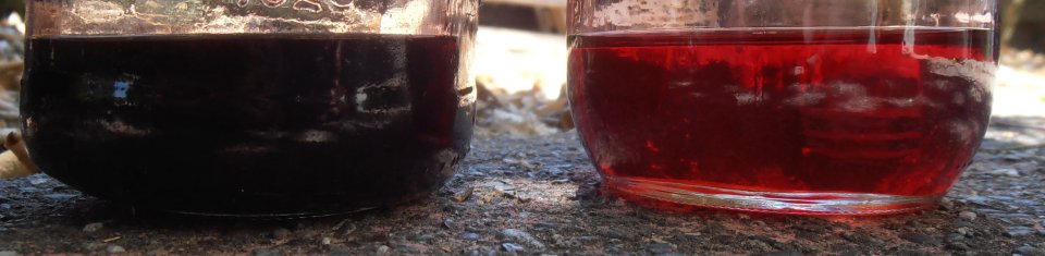

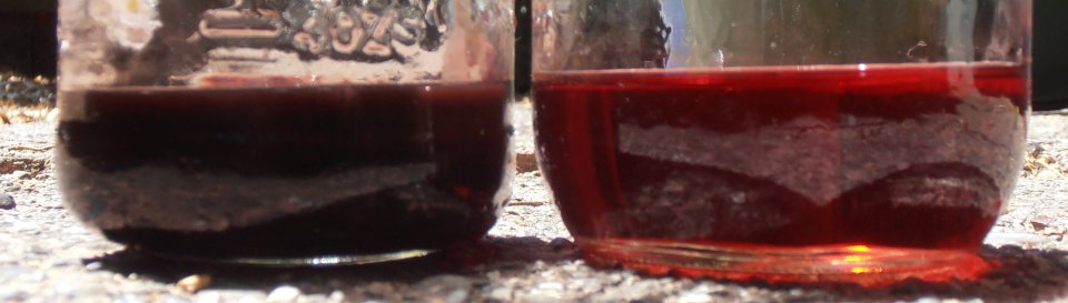

  15. Max Finch
    Max Finch Active Member
    Aug 10, 2017
    135
    131
    Medford Oregon
    I changed mine yesterday and boy does that feel nice! 118,000 and never a trans oil change. My old oil was black like the bottle it comes in new, and I'm getting significantly better mileage with the new stuff. If it's more viscous new then I'd imagine my mileage will continue to increase with time (as the new oil breaks down).
    SFO likes this.

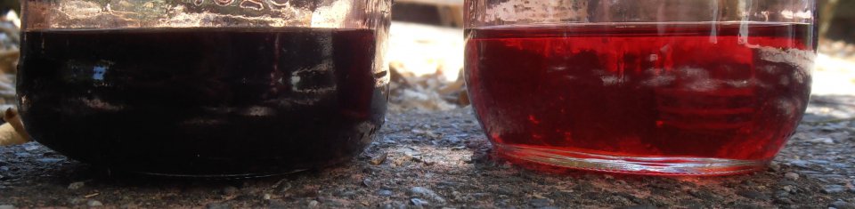

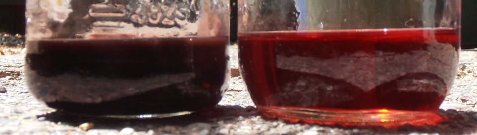

  17. Max Finch
    Aug 10, 2017
    135
    131
    Medford Oregon
    Yeah. Pretty easy, just messy.
