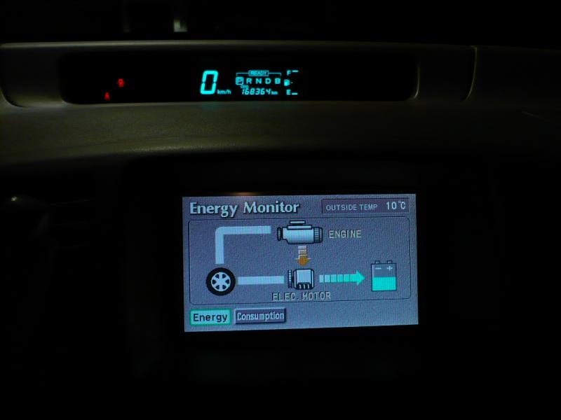

    Woo hoo!
    That's a happy hybrid screen!
    Had to post the quickie news flash because I wanted to finish the rest of the assembly/final torquing so we could take it for a spin tonight.
    When I first turned on the ignition I got the triangle of death and the hybrid system red flashy car icon.:eek::eek::eek: I was worried but still had hope that after I finished bleeding the inverter coolant it would be fine. You have to turn the car off and on a few time and bleed in between and the third time I turned it on the bad lights went bye bye. I started it up and the ICE ran and charged the battery.:D:D:D:D:D:D:D

  8. orange4boy

    Nice!
    Pretty cool the car starts its new life on thanksgiving.

    Nice work, congratulations on doing a great job. Thanks for posting the photos.
    I noticed your fuel gauge is reading empty. Is that because you just restored 12V power - or was the tank really empty?
    - How many miles on the newly installed transaxle?
    - After you've had a chance to log some miles, pls tell us the mpg reading per the MFD.

    A good omen. And boy, did I give thanks when it started up!
    Had just reconnected the 12V. Tank was a little under 1/2.
    Transaxle only had 19,000 Km. I confirmed this when I opened the oil pan and the sump was very clean with only a small build up of extremely fine particles (so fine it felt like a sludge) on the magnet. Oil was nice and red and viscous.
