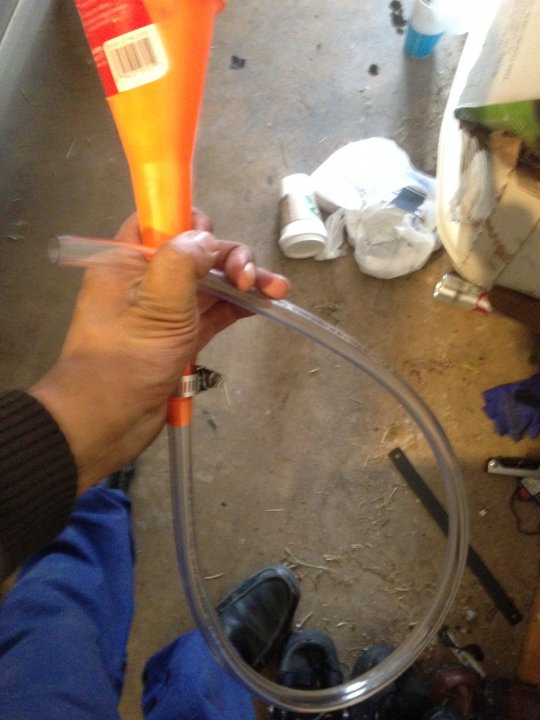

    1-2 ft of hose w/ outside diameter no larger than 5/8 in

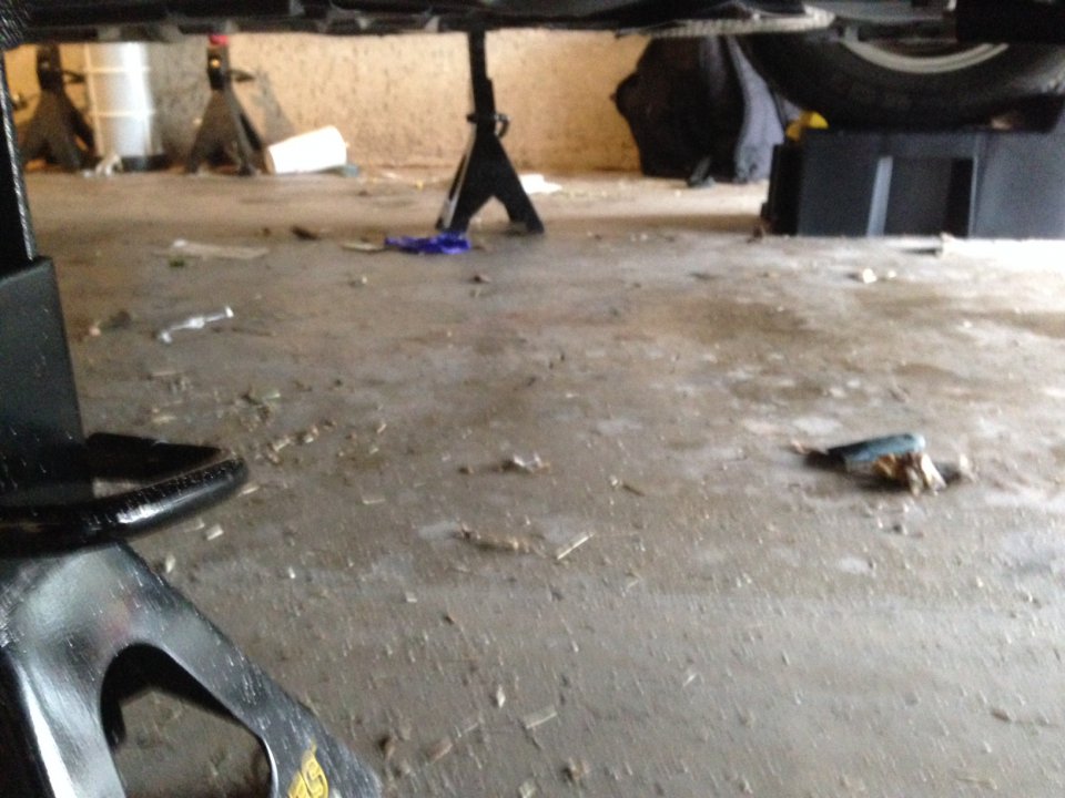

    1. Lift the car, I used 4 car ramps to on each wheel i back up the car on 2 ramps and used a low profile jack to lift the car and place the other 2 ramps on the front wheel. If you jack and jack stand method you must make sure the car is leveled or you will over or under fill the transmission.
    ***DO NO RELY ON JUST RAMPS/JACK USE JACK STANDS AS A SECONDARY SAFETY MEASURE last thing you want to happen is your prius killing you!

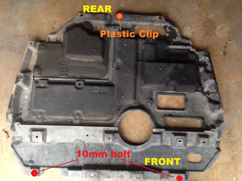

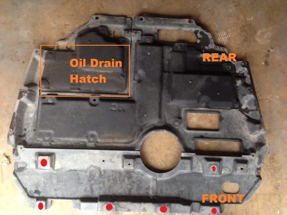

    2. Remove the lower panel this is probably the hardest part of this service, there are 6x 10 mm (see pic Red dots) all located in the front (near the front bumper) 10x small plastic clips and 2x Large plastic clips use a wide flat screwdriver and remove the clip, you may break a few as i did just take your time to remove them

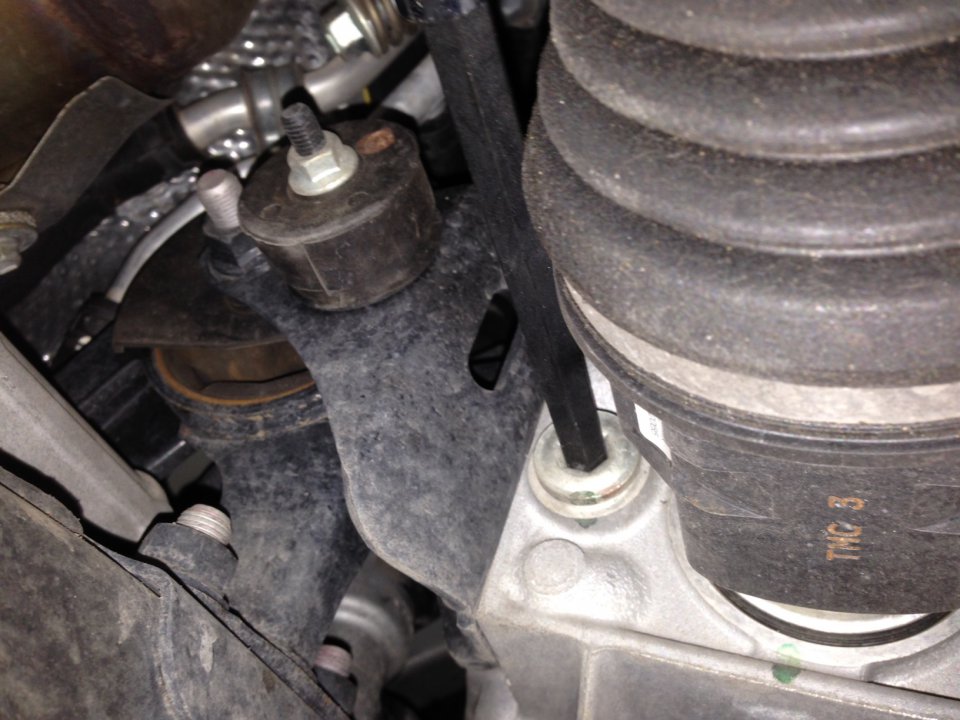

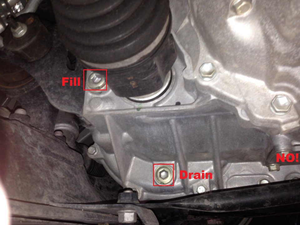

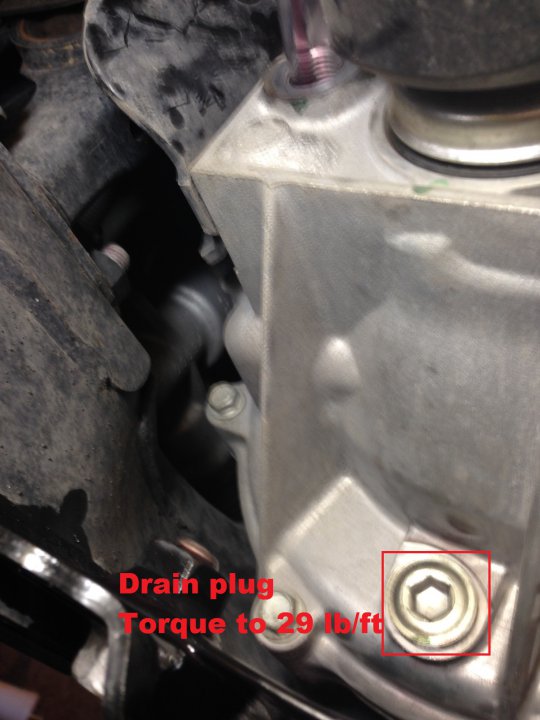

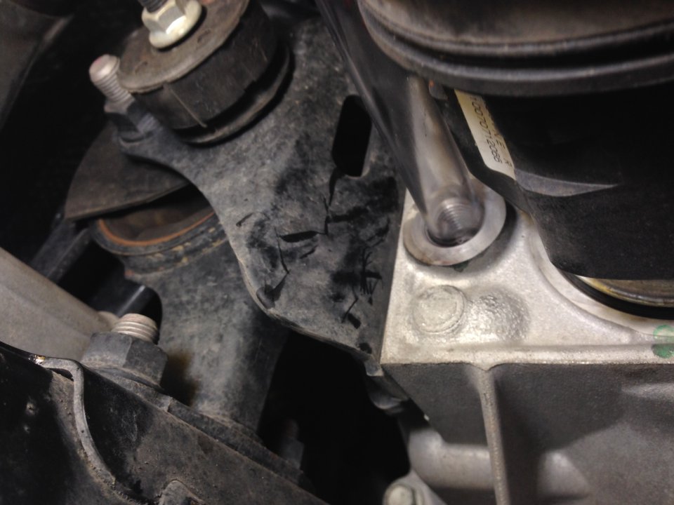

    3.Once you drop the plastic panel you should see the transmission on the left side (Driver side) and a cv shaft that is going to the right wheel (passenger side) behind that CV shaft is 2 plug one is drain the other is fill (see pic) p.s theres another hex plug that is under the transmission DO NOT TOUCH THAT plug (NO PIC)!
    4.REMOVE THE FILL PLUG FIRST! God forbid if you remove the drain plug first,draining the transmission and if you so unfortunately strip the fill plug theres is absolutely no way you could properly fill the trans you could make an adaptor and what not but its just more work. 10 mm hex drive make sure it sits/fits perfectly w/ no play.

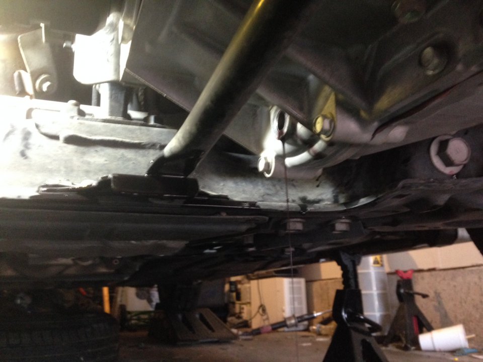

    5. Remove the drain plug same 10 mm hex drive...prepare for a gushing ATF fluid, get a drain pain that is WIDE enough to collect all the ATF. Measure if needed.

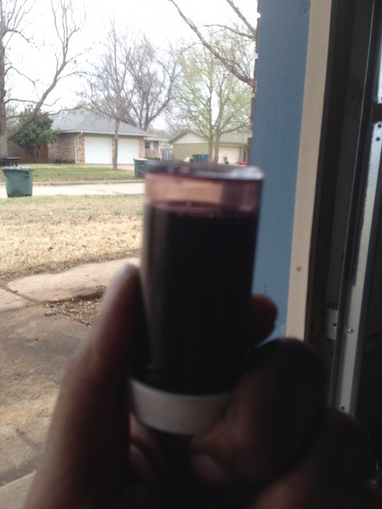

    Comment. 5 yrs old, 76k miles fluid looks like, it smells repulsive, has a dark red ash color and the fluid its viscosity has thicken, i was only able to remove 3 quarts, so i was short of 0.5 to 0.75 quarts short.
    6. Reinstall the drain plug with new washer and torque it to 29 lb/ft
    7. Grab your funnel and attach the hose to it.

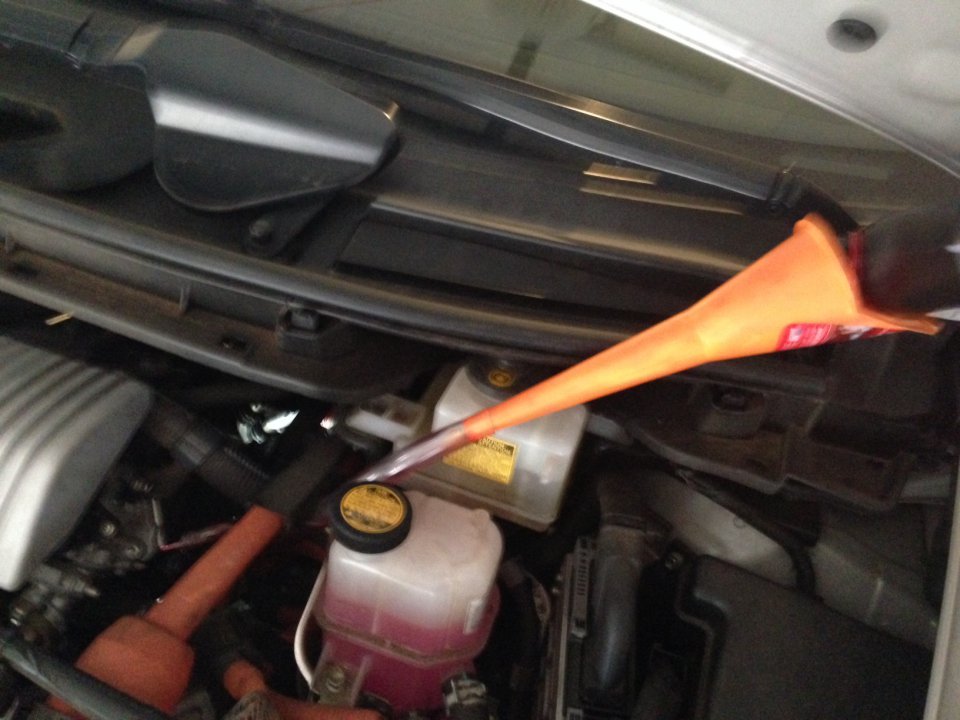

    8. Feed from the top side of the engine bay to the transmission I choose the back side of the engine near the brake fluid reservoir and coolant reservoir as the hose was able to fit into fill plug w/o kinking and all of the fluid goes into transmission and not a drop wasted. Using a 5/8in OD (1/2in ID) the fluid just flows right in w/o any problem and it goes in very fast too i was able to put in 3 quarts under 1 min.
    Toyota manual specs 3.5 quarts, i was able to fit in 3.75 quarts before it start dribbling from the fill plug.

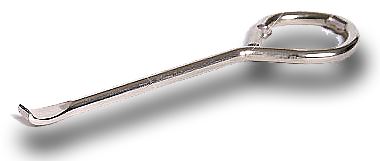

    Here's an improvised tool I use with clip removal, very effective. It's actually a paint can opener:
    jzchen, mtl and russellkanning like this.

    That strategy makes sense. If you can't use two tools at once, at least pry both sides in alternation with your single tool, a little at a time, instead of trying to pry only on one side.
    It should be possible to make an even more efficient tool than the paint-lid remover by modifying tweezers to give them hooked tips to grip opposite sides of the clip simultaneously. Then a simple straight pull should get the stubborn plastic pin out.

    Yes, good idea, something similar to a battery post clamp puller.
