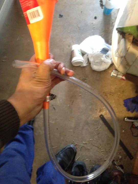

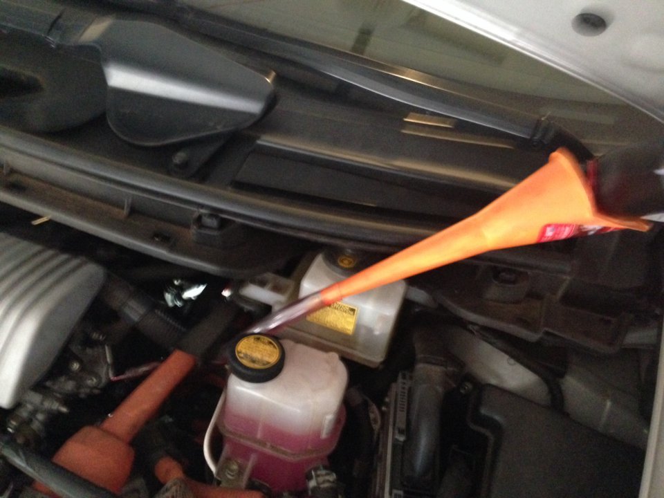

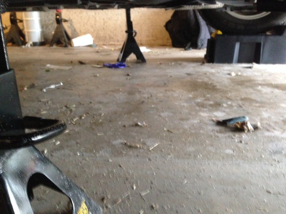

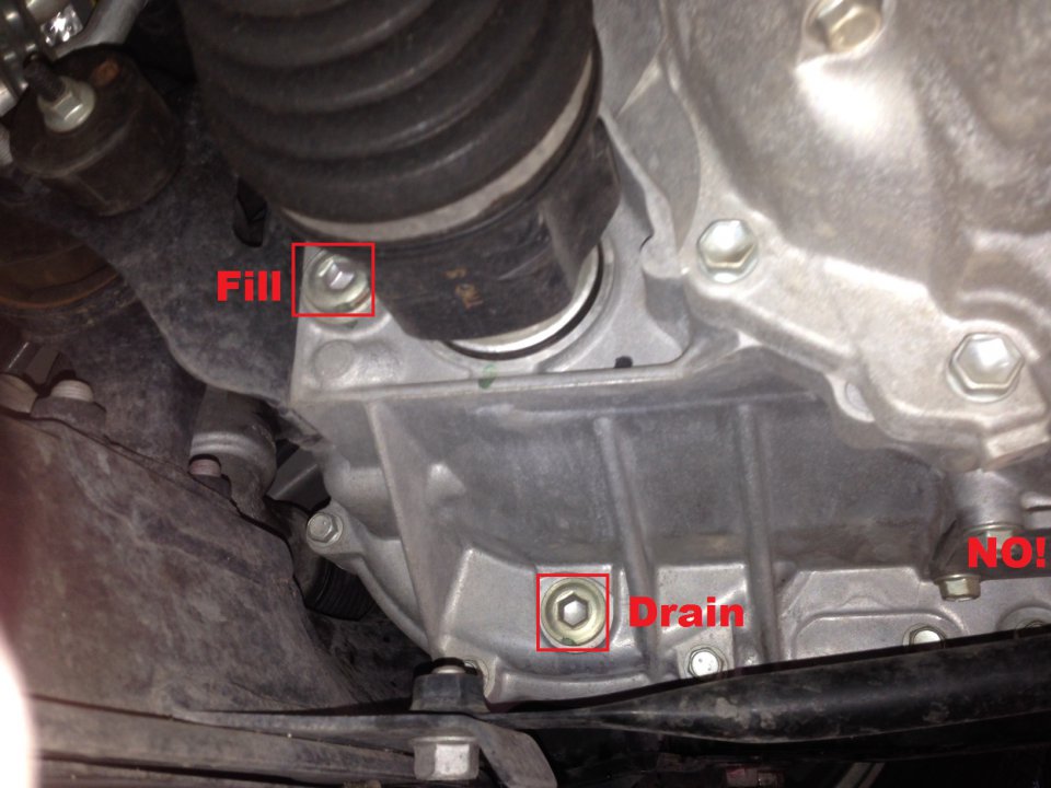

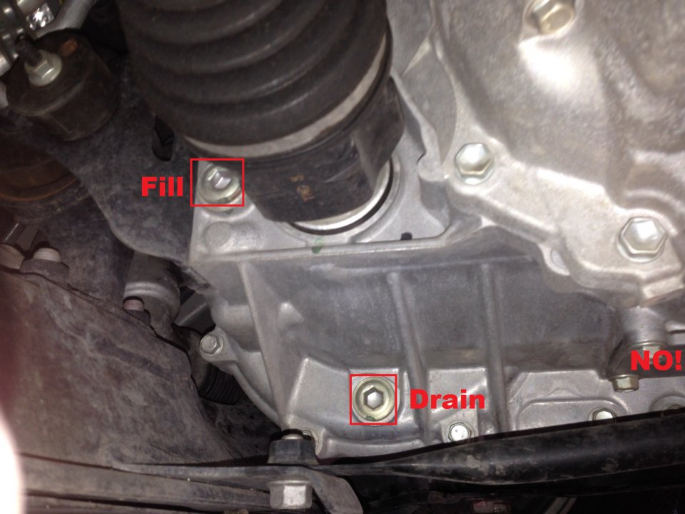

    No, that makes no sense to me: just change it. If you can handle an oil change, this is about on par, just a little different. You want the car to be raised and level. Drain the old, replace drain bolt, add new Toyota ATF WS till it starts coming out (hence the need for the car to be level).
    You can use a pump; I got by with a funnel with hose extension. You can pour 3 liters/quarts with impunity, then maybe slow down, just put in 100 cc at a time, till it overflows, which should happen somewhere around 3.5 liters. It helps to have an assistant pouring.
