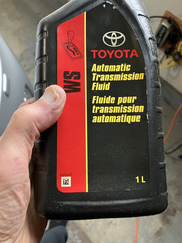

    I'd buy the fluid (Toyota ATF WS), and the fill/drain bolt washers, and let it slide till your back's improved. A fair price from a professional would be around $125; it's no more complex or involved than an oil change. There's a link in my signature (on a phone turn it landscape to see signatures) for 3rd gen transaxle fluid tips and tricks, but a lot in common with gen 2. Unfortunately there's nothing in the gen 2 repair manual regarding transaxle fluid change, since, well, Toyota says nothing about changing it. I'll attach the level check excerpt, for what it's worth.
    BTW, not sure what your source for ATF WS is, dealership? My nearby (Canadian) dealership has it for $11~ CDN per liter, roughly $8 USD.
