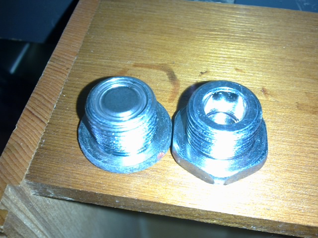

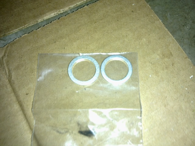

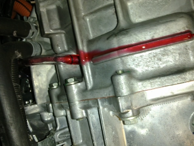

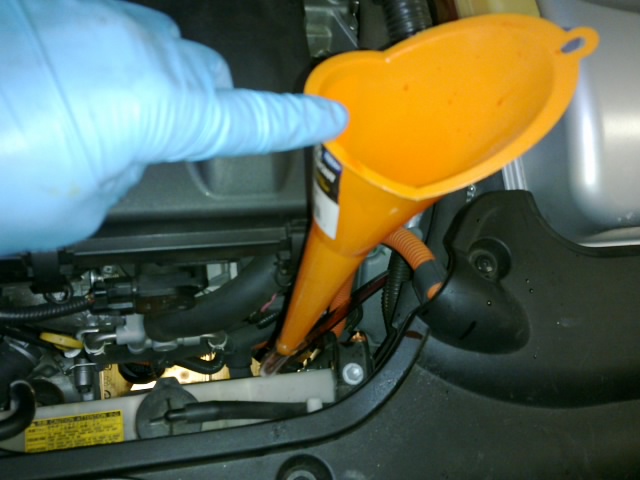

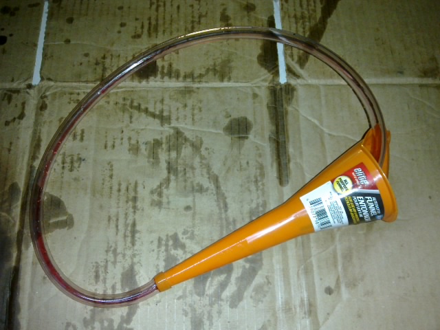

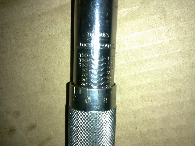

    31,ooo mile transaxle service done, thanks to what I learned here. Thank you all.
    So easy, 1/2" 24mm 6 point socket, 1/2" 10mm hex socket, 4 liters ATF WS, two washers, 32" hose, dollar store funnel and a torque wrench set to 29ft lbs. p.s. I didn't use my torque wrench to loosen the nuts, which is a no no.
    Drove onto the ramp and drained 3.9L, actually measured this time, then filled 3.9L.
    I didn't have to remove the cover to get the hose to the fill hole.
    I think I will do it again at 30k miles then every 60k miles. 042720141666.jpg 042720141669.jpg 042720141670.jpg 042720141671.jpg 042720141672.jpg 042720141673.jpg 042720141674.jpg 042720141675.jpg 042720141676.jpg

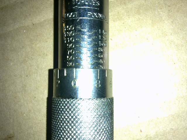

    4. Buy a 1/2" click type torque wrench and the necessary sockets (24 mm 6-point socket, and 10 mm hex key socket) and set the tightening torque to 29 ft.-lb.

    The $10 (with coupon) 3/8 inch Harbor Freight torque wrench is the way to go. It actually tested well against the very expensive ones. The 3/8 model is handier than the 1/2 inch model for most jobs on the Prius.
    Torque Wrench Testing - Shop Tools - Car Craft Magazine

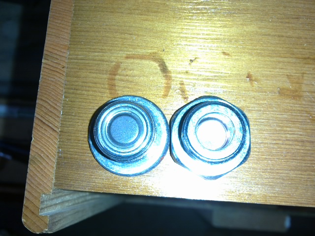

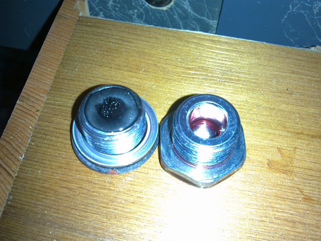

    I developed this special transaxle set, including a high strength rare earth neodymium magnet, that uses a 24mm hex rather than a shallow 24mm or an M10 socket plug.
    My transaxle fluid change and NEW custom drain and fill plugs... | PriusChat
    It eliminates a lot of extra tools for any future fluid changes, and the neodymium magnet realls catches the worn off iron and steel swarf. It works with ALL Gen II and Gen III Prius models.
