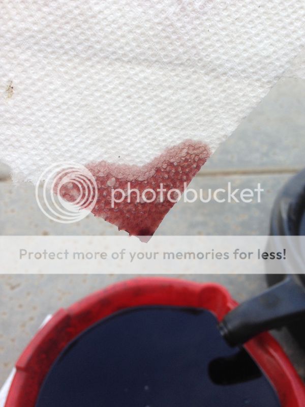

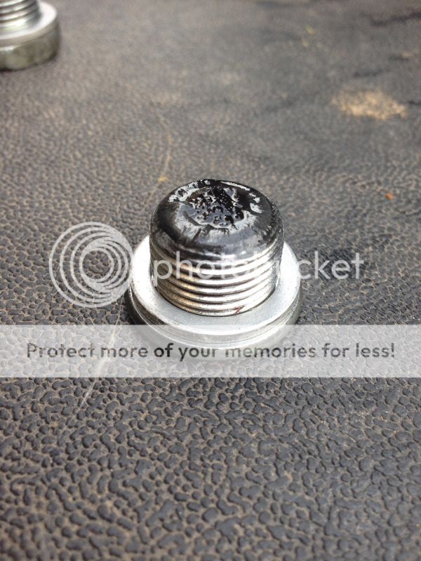

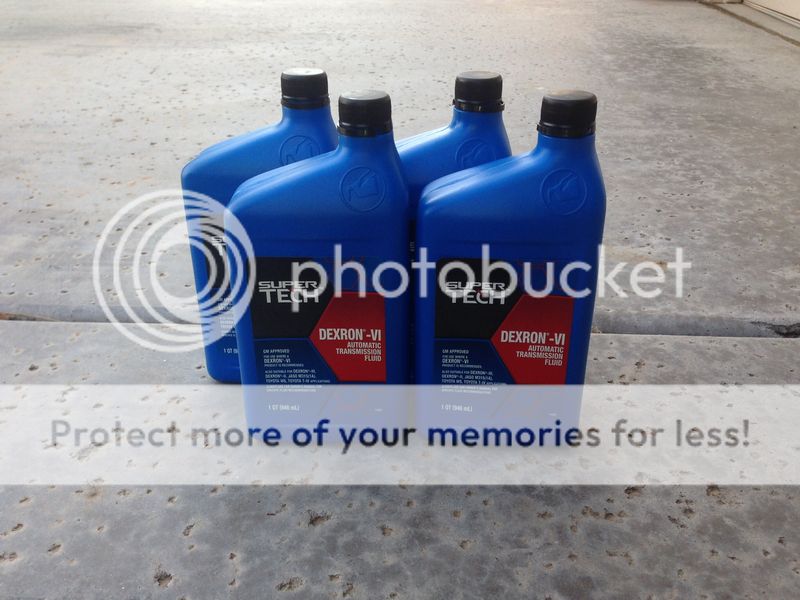

    Well it only took me 3 years of procrastinating, but I finally changed the transaxle fluid yesterday. Since my plan was to originally replace it at ~100K, I got 4 quarts of Super Tech Dexron-VI which says "Also suitable for Toyota WS applications". I only plan to leave it in for 1-2K miles, mostly as a flush. I will put in official Toyota WS fluid and replace the washers the next time I do this.
    Considering that the mileage ended up being about 150K, I thought the fluid actually looked pretty good. Here is some on the corner of a clean paper towel:
    I have no basis for comparison, but this is what my magnetic drain plug looked like:
    Anyway, as long as you have the 10mm hex key and 24mm socket, this is an easy job. I think I had about 3 feet of tubing on my funnel, less would have been better. I rolled the front wheels up onto Rhino ramps to loosen both plugs, then rolled it back off the ramps to do the draining and refilling. It was all uneventful except for the fact that this fluid comes gushing out unlike any oil I've ever changed before. Quite a bit splashed onto the bottom of the car and on the ground around the pan, fortunately it's easier to clean up than spilled motor oil. I poured in all 4 quarts, some leaked back out into my drain pan. I tightened both plugs as well as I could with the car on the ground (not a lot of space), then I rolled it back up onto the ramps to make sure everything was tight and to wipe things down. Anyway, if you can change your oil this is simple, so don't be afraid of it ;^)
