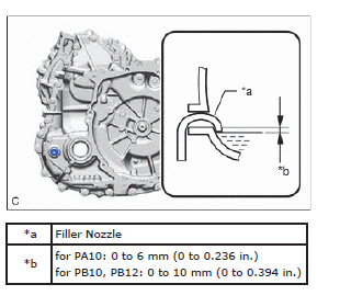

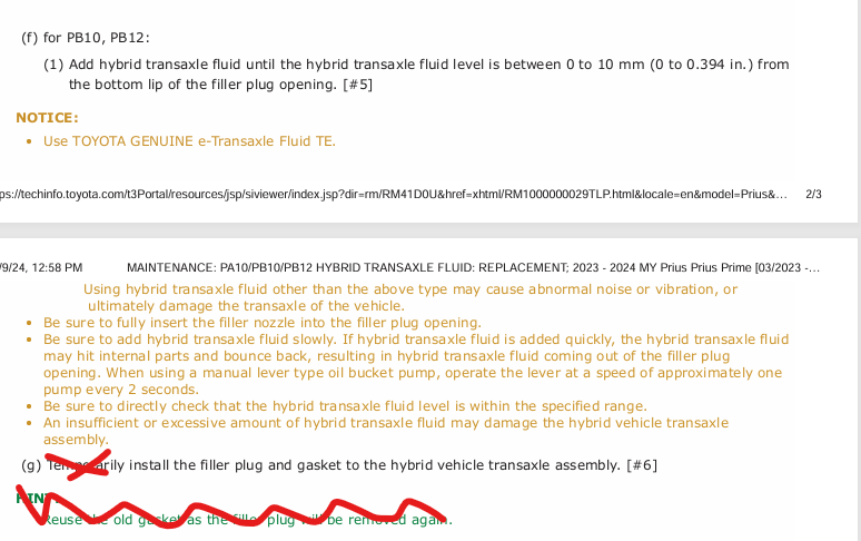

    With the car level, this is how to check the level:
    Yes, with the car level. Instruction says to run the car in maintenance mode, then check level again. In practice that last check seems very onerous. I did it first time, absolutely no change. I'd just check for leaks, but if you installed both bolts correctly, with the washers, you'll be good.
    Note, the attached 5th gen Repair Manual instruction drones on excessively, I would edit thus:
    And ignore everything thereafter. I can't even make head-nor-tail of it...
