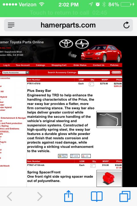

  16. reaction26
    reaction26 Junior Member
    Sep 27, 2007
    39
    DC
    I'm in va how much will shipping be? Brand new at dealerships are going for $223.76 with shipping.
  17. Bullet Salvador
    Feb 17, 2013
    109
    44
    Los Angeles
    I got mine 25% off retail, $209.25 plus tax.
    Most Toyota parts stores give 15-20% coupons if you ask or look online at there website. On rare occasions they give 25-30%.
    Simply research your local Toyota parts place and ask to talk to the parts manager. I hope that helps. =]
