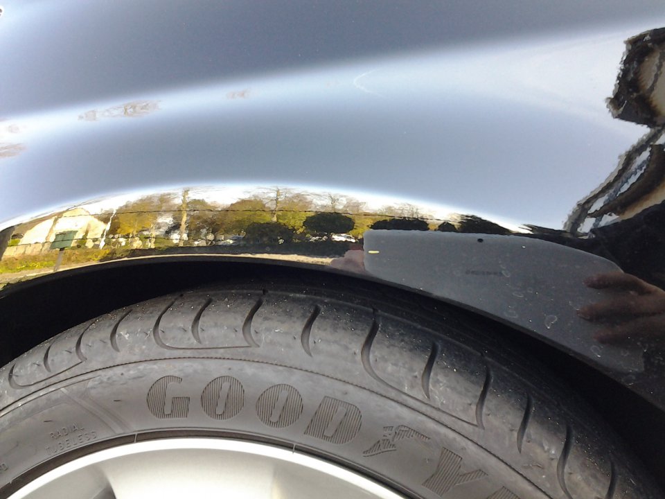

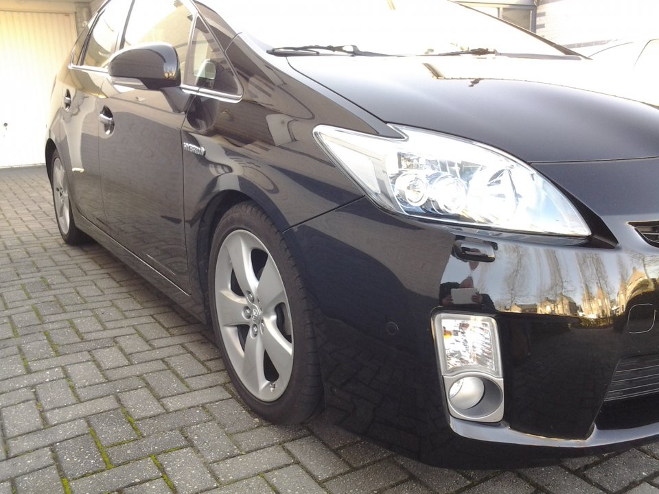

    Any photos since lowering? How many mm is it supposed to be lowered on the h&r s?
  14. Europe Amsterdam Area
    Aug 31, 2014
    The Netherlands (Europe)
    I ll post some pics later. It s supposed to lower 30mm in the front and 30mm at the back. But after installing it more like 40mm front and 30mm rear.
  15. Europe Amsterdam Area
    Aug 31, 2014
  16. Europe Amsterdam Area
    Aug 31, 2014
    Pic with the biggest gap is the rear. Pic with the smallest gap is the front.

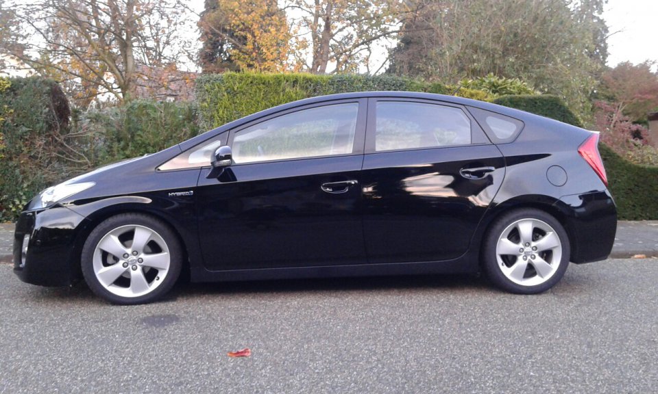

  18. Europe Amsterdam Area
    Aug 31, 2014
