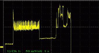

  17. ChapmanF
    28,640
    18,960
    vvillovv may have meant testing the 'trick'.
    The goal is to get the system main relays to click in and the DC/DC converter to fire up, at which point the 12 volt system is no longer running on the 12 volt battery, and the 12 volt battery is getting a charge.
    Pressing the brake pedal and the power button is the usual way to do that. But the remote A/C button also does that.
    The claim being proposed is that the remote A/C button may still succeed in circumstances where the usual way won't.
    A comparison of the startup current profile drawn from the 12 V battery during the few seconds it takes for the hybrid system to come online (in either method) would be something solid to look at.
    We already have such a thing, done for Gen 2 about a dozen years ago (at least, as of this writing, the page it comes from is shown by Page Info to have a last-modified date in January 2010).
    Maybe the time is ripe for somebody to make the same pictures for a Prime, and both ways, with the power button and with the remote A/C button.
