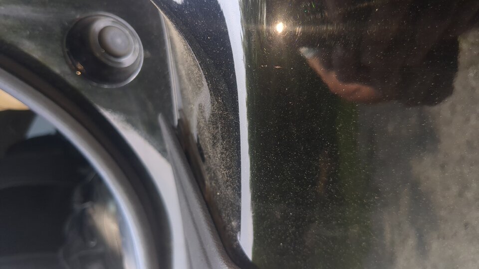

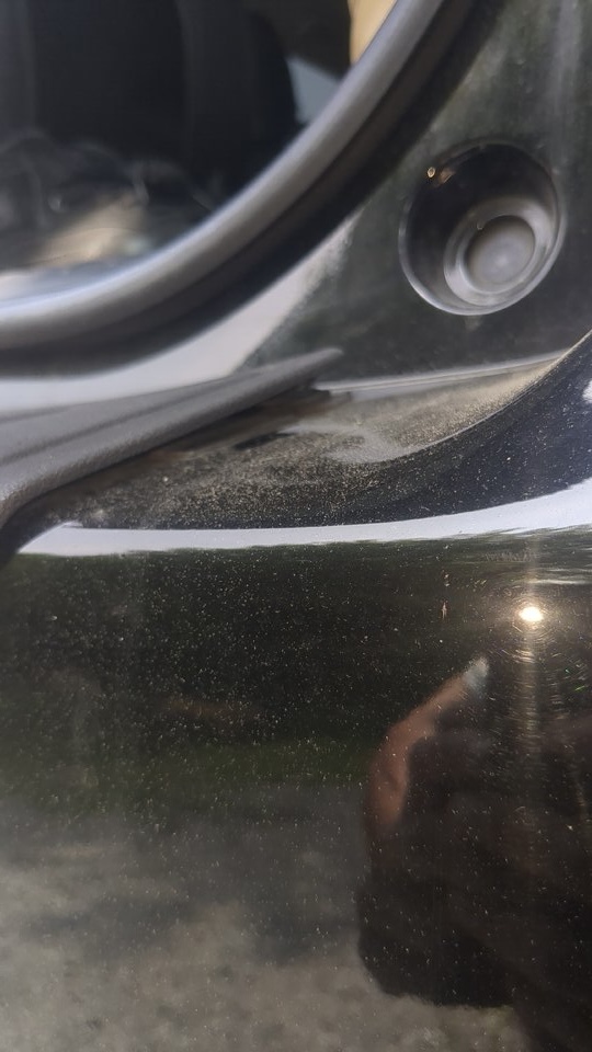

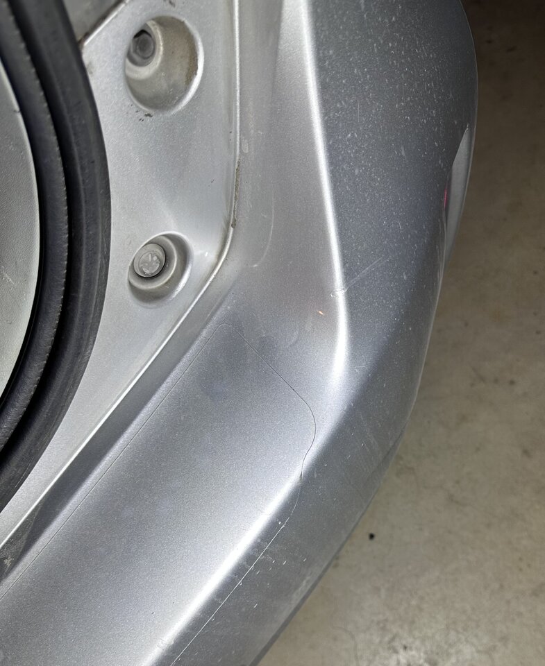

    Anyone else had this annoying problem? The plastic trim in top of the rear bumper is lifting up from the edges. It's enough that the hatch catches it when I open it, so I need to push down the trim piece to open the door. So annoying. I'm not sure if I can fix it or should buy a new one from the dealer.

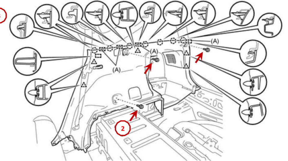

    It would help to post a pic of the area from a distance for perspective. While not sure of the exact piece you are talking about, the odds are good a push pin connector or screw has failed.
    A wag on the panel (car is with the wife)
    Red indicates screws
    Mendel Leisk and Air_Boss like this.

    They are talking about the bumper protector on top of rear bumper cover, not the interior.

    Here’s op’s first pic, rotated to what I think is correct orientation:
    ^ Looking down at right corner of rear fairing (aka “bumper”).

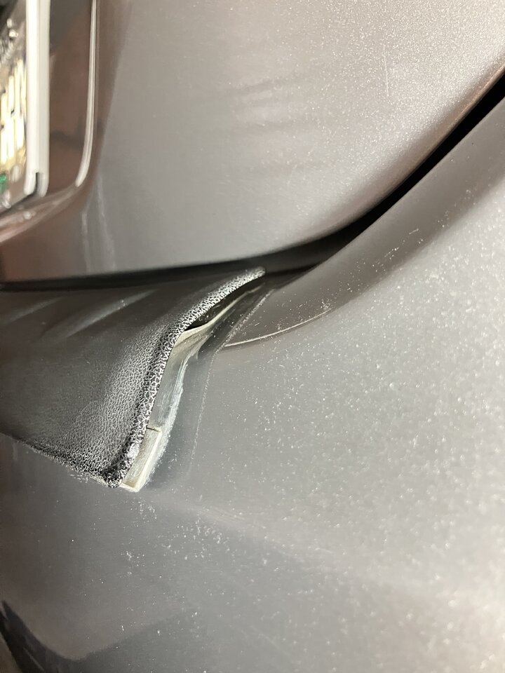

    Second pic, rotation fixed similarly:
    ^ crouched down in same vicinity, looking horizontally at right edge of rear fairing threshold protector.
    @PriusCamper nailed it I think, maybe a strip of double-sided adhesive tape.

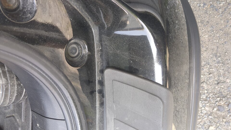

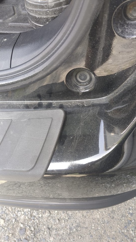

    We’ve got what looks to be same (or similar) threshold protector on our 2010. It’s lifting off its adhesive tape, but not enough to catch on hatch.

    Not sure why those pics got rotated. They open correctly on my PC I uploaded them from. Fair enough if it's glued down, I guess I'll try to reglue it. I was hoping it was a broken clip that would be more secure. I don't really like glue.
