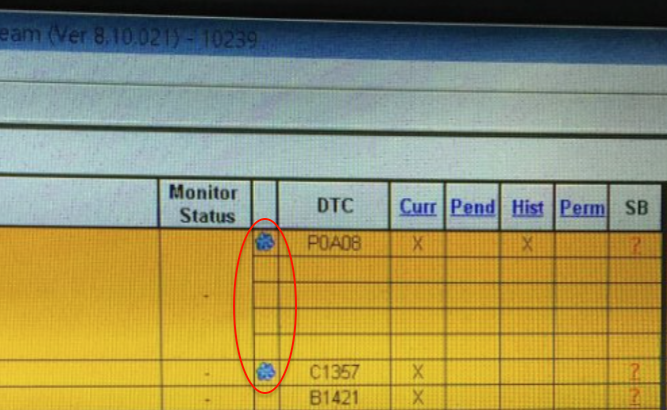

    144k miles and no there wasn’t any step by step to follow. Or if there was I didn’t know how to get into it. When the little snowflake appears is that when you can see it?

    i think you click on the snowflake

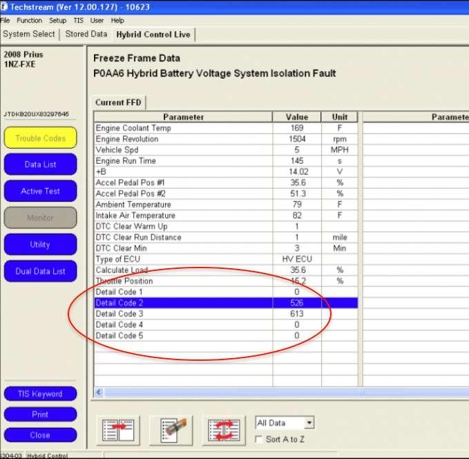

    When techstream offers a code (DTC) with a snowflake to the left of it, click on the snowflake to find/locate the related 3 digit subcode (AKA : detailed code, or INF). Knowing any related subcode(s) may help in isolating and potentially fixing the issue in a timely manner.

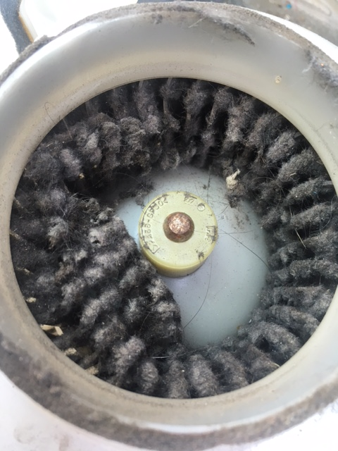

    Be sure to clean the HV battery fan, and the related connections as well :

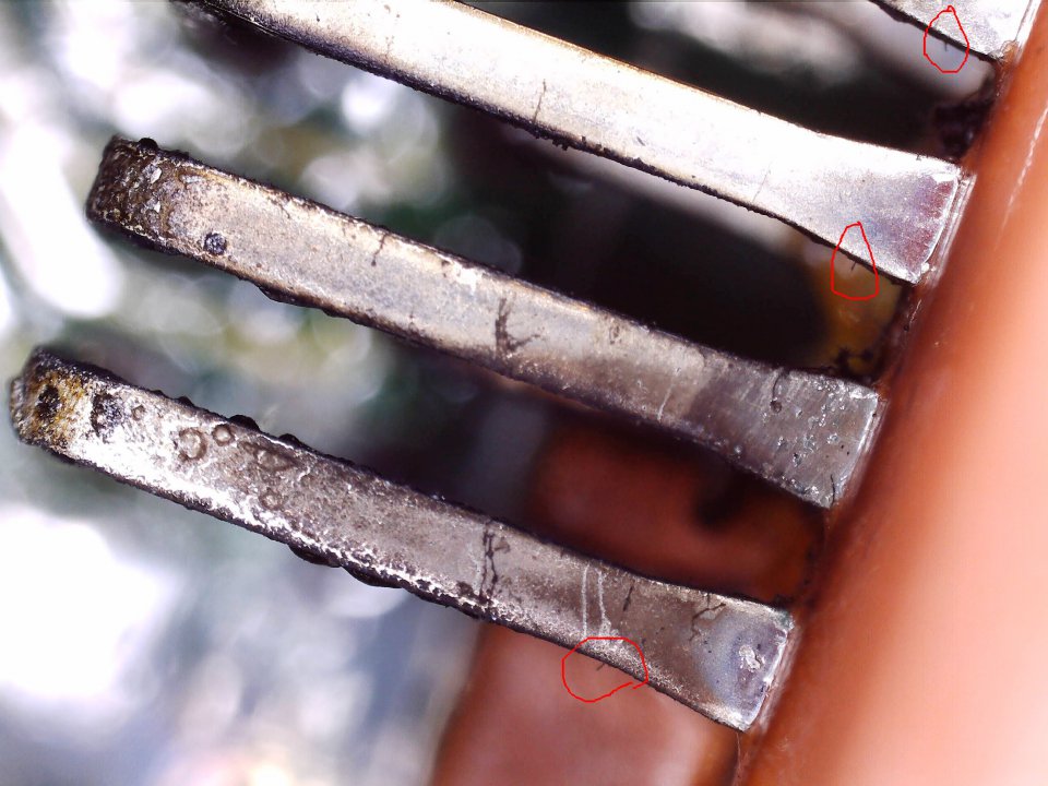

    The patina showing on the connectors below is corrosion :
    Notice the broken pin in the connector below :
    maleko, Thomas Brazen and bisco like this.
