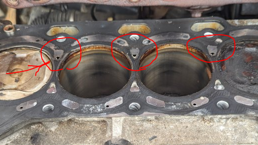

    Yeah "almost" failing on all 3 inside walls, and cylinder 1/2 wins the race. The EGR passages in the intake manifold tend to clog sequentially, with cylinder one leading. This is without fail what happens, when 3rd gen EGR is left to clog, somewhere between 150K and 200K miles.
    Thanks for the follow up.

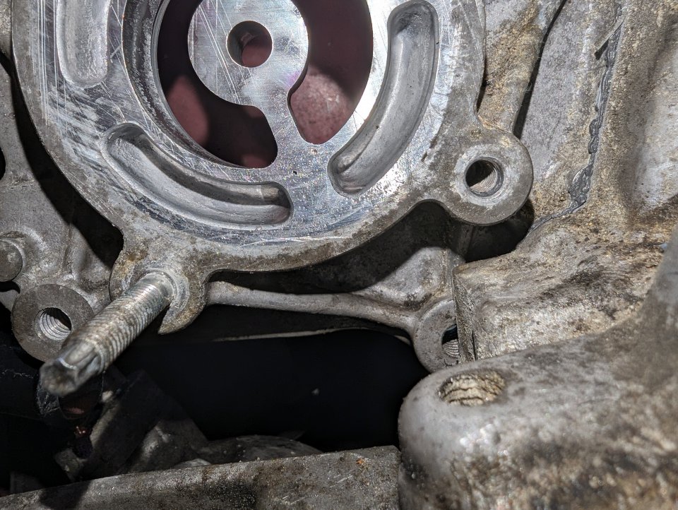

    Dammit. Got the replacement parts, but I can't get the bolt on the bottom engine side of the thermostat to thread. I don't know if it got overtightened last time so now after getting it off I can't get it back on or what. But damn, that's pretty bizarre and annoying and perplexing.
  20. cegeddin
    cegeddin Junior Member
    May 12, 2023
    72
    22
    Oxford, NC
    Looks like it is messed up at the entrance of the bolt hole
