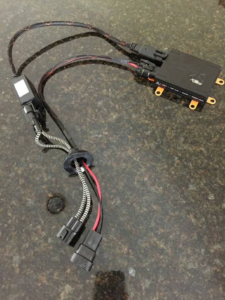

    Here's what I installed originally.

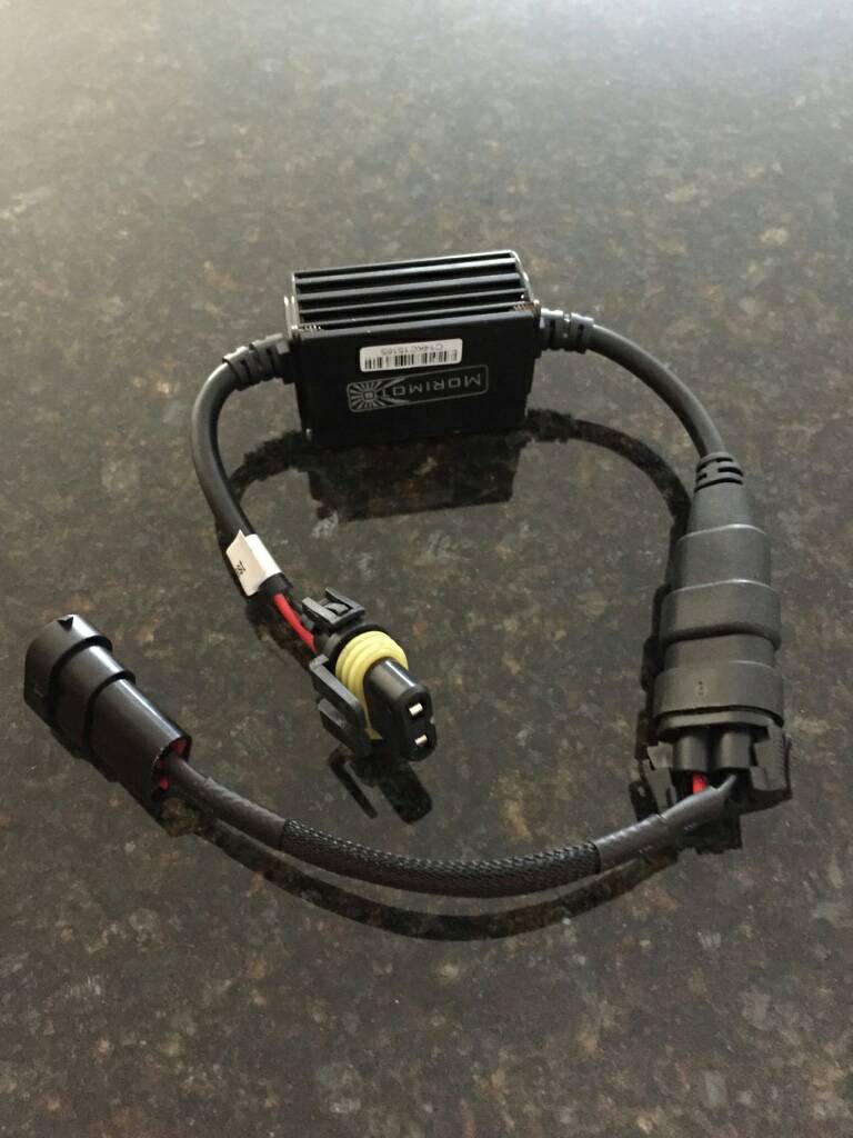

    Did you use the heavy duty dual relay HID harness that came with the kit? The symptoms sound like you got a harness with glitchy relays.
  15. 4rpr15
    4rpr15 Senior Member
    Jul 16, 2015
    1,056
    375
    WI
    I used the Canbus relay.
