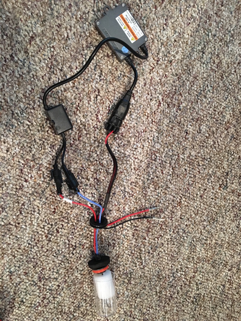

    Received the Alpha Kit. This it looks and feels great. The only thing I'm stumped on is where the red and black wires plug into. [​IMG]
  13. xliderider
    xliderider Senior Member
    Apr 19, 2012
    8,140
    3,276
    Honolulu, HI
    Those plug into your oem lowbeam connector (the one that would've plugged into the oem bulb.
    It's a bad sign that they didn't provide the H11 connector for your application. :(
