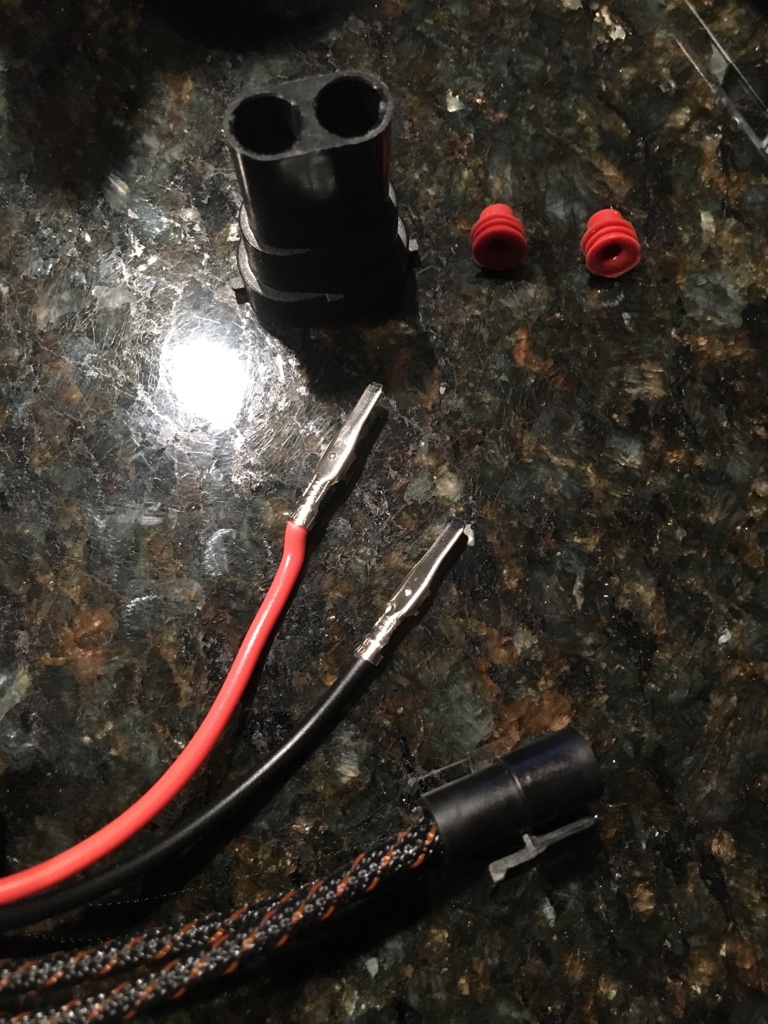

    Received the TRS 6500k Morimoto h11b kit today. How do I connect the bare terminals into the plastic socket connector? Where do the red rubber plugs get installed?

    The red rubber will stretch over the terminals. The part with the ribs goes on first. The terminals are flat and they go up-and-down in the connector. If they don't click and lock in then remove, rotate 180 degrees and reinsert. As for the polarity, that depends on the wire colors you have

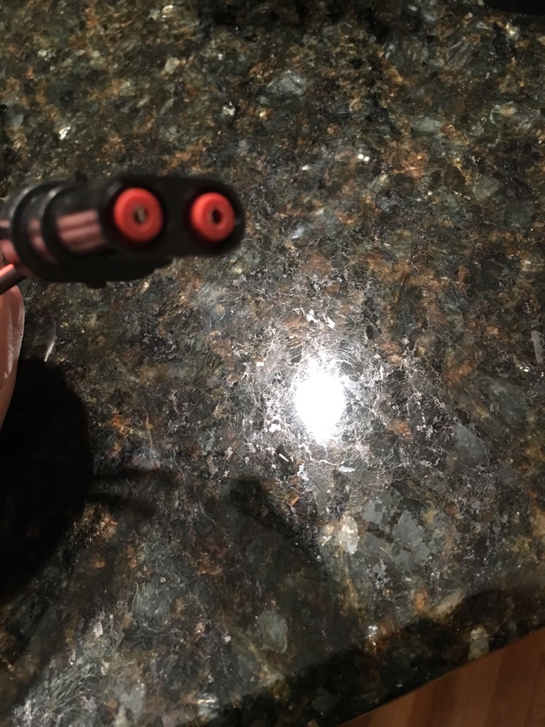

    Is that correct?

    They go over the connectors on the end of the wires, then make a seal between the wire and the connector shell when you insert the connectors into the connectors. The small end of the gaskets face the terminal end.
    Do a test fitting of the bare connectors first, to determine the polarity of your factory plug, before doing the final assembly of the connector.
    Also, when inserting the terminals into the connector shell, be sure to insert them facing the right way. They need to be inserted correctly, or they won't lock into the connector shell.

    Why does this show a shadow when I ordered an h11b bulb?

    Nope, they go onto the wires first. See my previous post.
