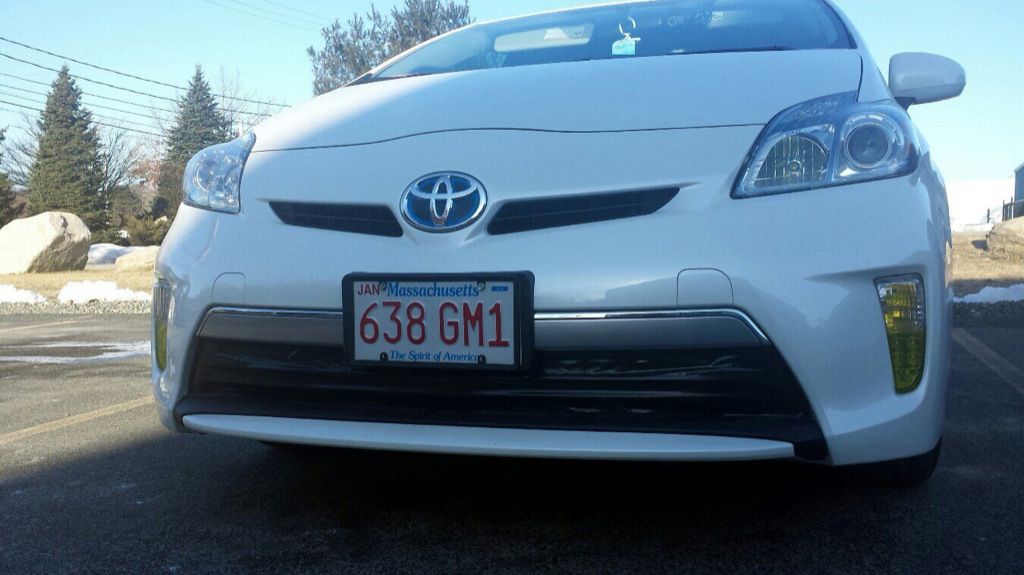

    My black duct tape grille block. 100% lower grille blockage. Redid it once this winter. And cheap too!
