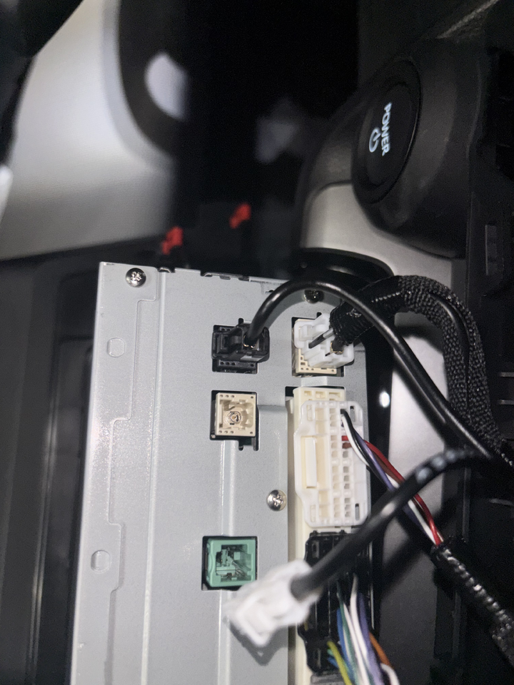

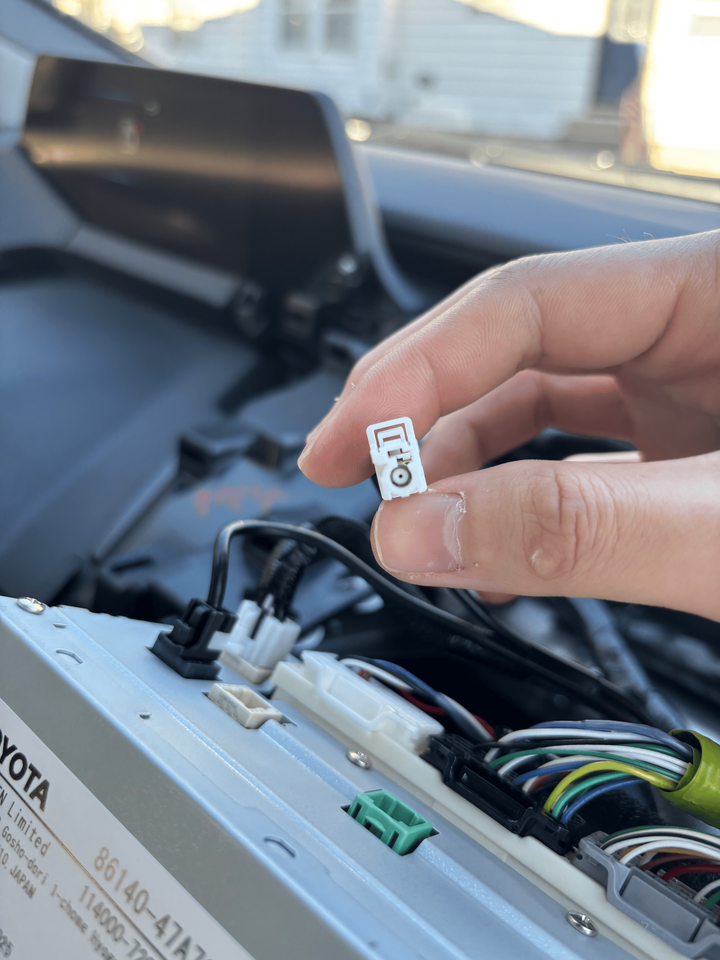

    IMG_2699.png IMG_2689 (1).png trying to figure out the name of the gps antenna connector that's connected to my 2026 prius head unit, any idea what this is? Also is this the GPS antenna? or is it the black one

    In my readings on disabling Telematics (DCM), that does look similar to the gps antenna connector on the DCM unit. (I'm leaving as is for now.)

    Hey there! thank you for the information! I am trying to add a gps tracker to my new Prius! I dont want to pay the subscription on the one in market, so I reckon I can probably make one. One thing about those is that the GPS signals are some very weak signals, so I thought there's already a gps antenna poking out of my car so why not use those! My plan right now is to use a splitter, but those connectors don't look like Fakra C or Z to me, and also if the car uses the same antenna for Cellular it probably won't work, I am just looking for options here haha

    Unfortunately, it doesn't look like any of those :(

    From the couple pictures you provided it looks like it may be a Sumitomo High Frequency Connector. Here are a couple of screen shots with links to the housing Sumitomo pages where you can view detailed drawings:
    6098-9503
    6098-9506
