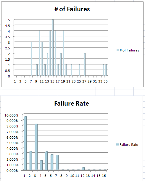

  14. Moving Right Along
    Moving Right Along Senior Member
    Dec 29, 2016
    739
    596
    Since Prius batteries very rarely fail before 10 years or 100,000 miles, "older or higher mileage" in this case means more than 10 years and/or more than 100,000 miles. I graphed out battery failures from True Delta data a few months ago. The top graph shows number of failed batteries on the left axis and mileage (x10,000) on the bottom axis. And the bottom chart shows failure rate percentage on the left axis and model year (+2000) on the bottom axis.
