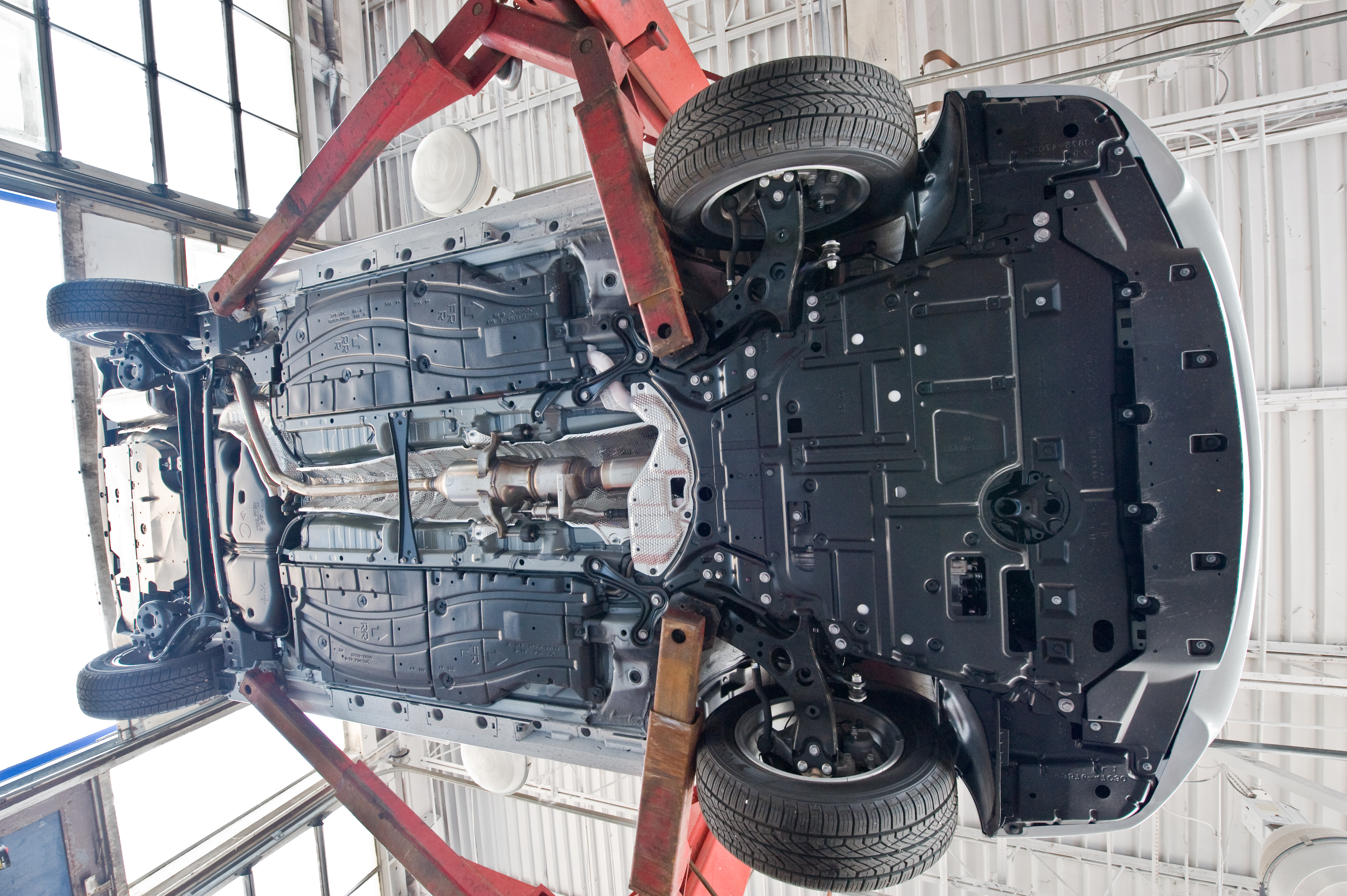

    US
    I just had mine fixed today. The oil door was hanging down slightly, but could not be attached by a clips anymore after only 2 oil changes. The service writer checked if they did the oil changes (they did), took the TSB printout from me and I had it fixed and car washed in 1.5 hrs.
    When I came back and looked underneath, I saw more openings that I remembered in the old one, especially on the transaxle side. I took some pictures. Is this for more tranny cooling? Or is my recollection wrong about the old panel?
    BTW, the TSB specifies part number 51410-12103. The installed part # is 51410-12104 on the sticker, but they called it 51410-12105 on the receipt (newer version?).
