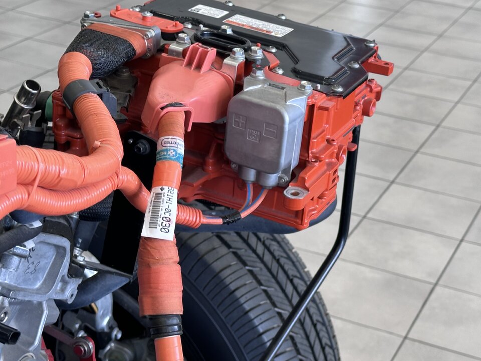

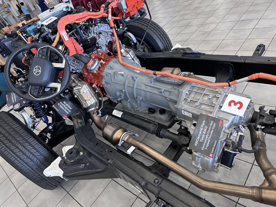

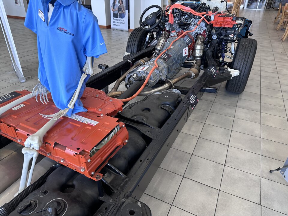

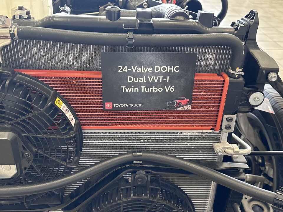

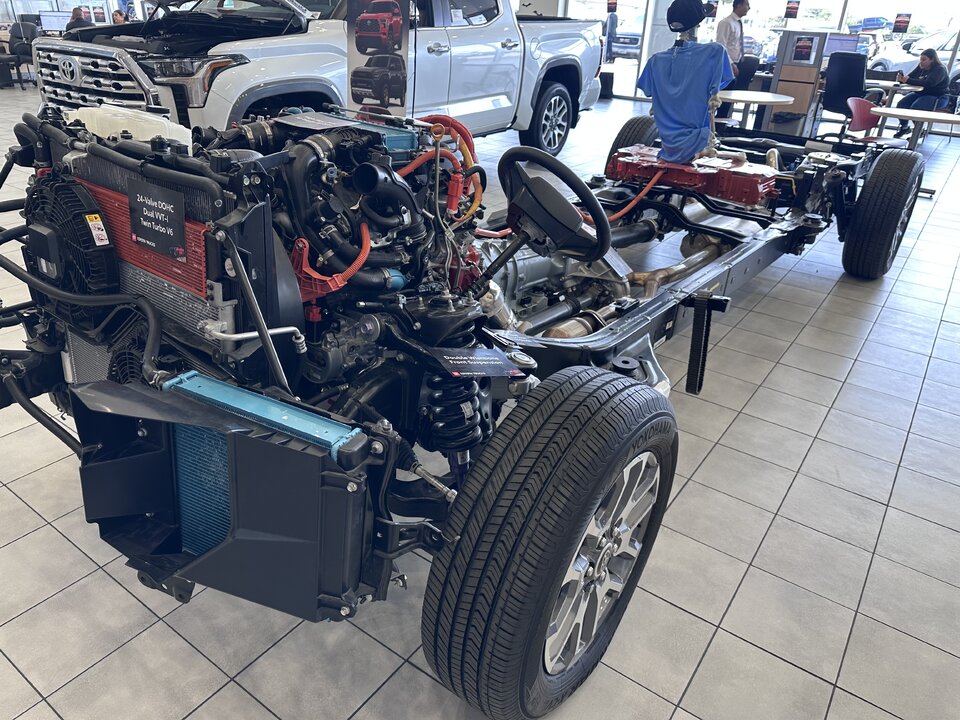

    Tundra Twin Turbo V6 Hybrid AWD
    Inverter
    Electric Motor
    Inverter Cooler
    Nimh Battery
    Front view of stripped down model

    The theory is that the hybrid motor provides the low end torque as the turbo spools up - getting rid of the turbo lag, flat spots in the power band.
    It's a regular transmission, NOT like a Prius transaxle. The electric motor replaces the traditional transmission torque converter. It's suppose to have more low end 'grunt' while rock crawling.

    They use a ten speed automatic behind one hybrid motor.
    The Tundra takes advantage of its electric power and torque at the low end like other hybrids. Overall it's pretty fast with a zero to 60 around 5.6 seconds. MPG is minimally improved by 2 mpg so power is the selling point.
