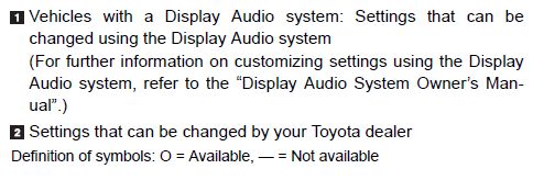

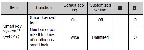

    Doesn't apply to the c as covered under Section 6-2 of the manual.
    From one of the 2013 US manuals:
    Without doing anything, SKS goes into some kind of power saving mode after 5 days that supposedly means it takes longer to respond (although I didn't observe this when I came back to the car after >5 days) and after 14 days it can only be used with the driver's door (ie. not at the passenger door or at the rear hatch).
