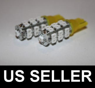

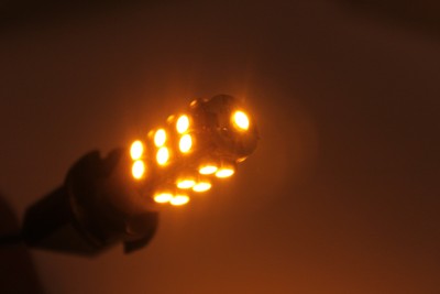

    I put the 25-way LED in the top of the headlight housing (which is normally a parking light, but is now a turn signal). It looks like this:
    [​IMG][​IMG]

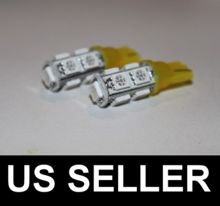

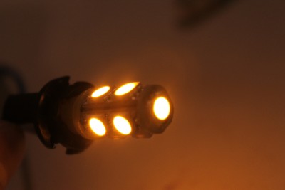

    The 9-way LEDs I also have look like these:
    [​IMG][​IMG]
    You can see the top LED on the 25-way is small, so it doesn't produce much heat that would affect the headlight glass. But the sides to illuminate a lot more and the light reflects better in the housing.
