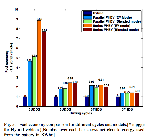

    You keep saying blending is always better with no justification. Its simply not true, no matter how many times you say it. I figured I'd let you go find papers showing its better at least some times, but you did not even do that. I knew they existed as I've read many. For example, below is a chart from a paper on
    Effects of Different PHEV Control Strategies on Vehicle Performance
    Which shows the relative MPGe efficiency gains for different strategies in different architectures on different driving tasks. In many of these the EV-frst mode is more efficient, even for a parallel PHEV architecture. For example a parallel PHEV on 3 hyway trips gets 2.2x hybrid efficiency if in EV mode and only 1.95 if in blended mode The differences are much larger for series PHEV, e.g. in City driving. The optimal strategy is complex. The paper concludes concludes
    The optimal fuel usage stragey depends on knowing the intent of the driver as well as the complex issues of the drivetrain and the road load, so no car can do that now. It also depends on the vehicle modes used and if there is more battery than needed, just enough or too little.
