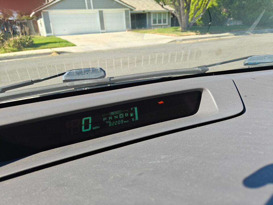

    My little brother told me that a turtle light had appeared and that the car became sluggish, and that it disappeared while he was parked relaying that information to me. He was able to drive back home without issue. When he got home I scanned it with Torque Pro but there weren't any fault codes recorded? What do you guys think?

    Yes, gen 1 had a turtle light, which would come on in circumstances where the car was reducing demand on the battery to protect it. Circumstances where the battery was extra hot or extra cold would be examples. I got it one time while driving slowly up the narrow road from the base of the New River Gorge Bridge.
    The light comes on to caution you that you might not get as much zip as you're used to if you goose the go pedal. As soon as conditions are comfortable again, the light goes back out, and you have the accustomed zip again.

    I'm guessing he was driving in hot weather. The traction battery has a fan which pulls room temperature air from the cab, but under some conditions the turtle light comes on if the battery is too hot or cold. The only time I saw the Turtle was when temps reached -30F.

    The Turtle will also come on if one (or more) of the HV battery modules drops below or goes above its normal operational range—hard acceleration or heavy regen can sometimes cause this, especially if there's a failing module or if the modules are out of balance. If it starts doing this regularly then you should try and get a scanner that can record the module voltages while driving. That way, if it's modules out of balance and you're electrically inclined, you can maybe balance the pack manually before it gets too bad and ev range falls and mpg suffers.

    Apparently, Gen I TurtleMode does NOT set any fault codes (DTC) for Techstream to pick up, even when lit.

    I am sure that the turtle light does come on for the reasons given in the owners' manual and reviewed upthread in post #2.
    I am not sure that the turtle light comes on for reasons other than those.
    The car does monitor for voltage / charge state / IR imbalances between modules, and has trouble codes and a red triangular light for reporting those.

    I got a turtle light exactly once, so far. It was in 2007 or 2008, in the summer. The car sat outside in hot weather, 95 to 100 F, all day, and I got the light when I went to drive home in the evening. I don't remember how long it lasted, but I think it went out on the drive home (about 10 miles). I think I ran the A/C in the car, which also supplies the traction battery with cool air.
    In July, 2010, the battery failed - one module went bad.
    I've never scanned a car with the turtle light on, so I don't know if it sets a DTC, or is otherwise available in Techstream. As above, Toyota calls it the "output control warning light".
