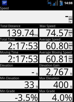

    Well I don't mean to flood the forum with posts, but this is quite different than my previous thread which showed a short trip with ideal pulse and WS opportunities and resulted in 72.2 scangauge mpg (my guess is that equals ~70 MFD mpg) over 30 miles.
    This trip includes the departure and return drive on I95 and the New Jersey Turnpike from zip codes 21231 to 08831. The results reported here include highway mileage only (no slowing down for ramps or highway approaches) plus slowing down for four tolls and being impeded by a bizarrely behaving grey Prius driver. Blue envy? Traffic was not a problem.
    Here are the graphs and data showing elevation and speed
    This portion of the trip yielded 60.6 MFD mpg. Interestingly, miles 0-68 (significant hills) showed 62.0 MFD mpg meaning that the second half of the drive yielded ~59.4 mpg. The return trip showed yielded 61.8 mpg according to the MFD with an average speed of 60.63.
    This discrepancy (60.6 mpg to NJ and 61.8 mpg return) suggests that further improvements are possible. Turning A/C off could also help a bit. I'm also wondering what the cruise control results would be :) High-speed tolls, instead of stop and go tolls at miles 32 and 56, see blue line dip, would also help.
    Anyhow these efficiency numbers were obtained using an adopted protocol from Hobbit's sweet spot refinement article and are summarized below:
    Slight uphill accelerate so that your iMPG = MPH (12.0 kW)
    Moderate uphill accelerate so that your iMPG = 0.8xMPH (15.0 kW)
    Significant uphill iMPG as close to 0.8MPH as possible
    Moderate downhill iMPG =1.3 or 1.5xMPH (8.0-9.0 kW)
    Significant downhill use Warp stealth also known as yellow arrow condition, by feathering the gas pedal (0. 0 kW)
    Tire pressure was 44 psi, but the stock tires are a bit worn from 50 months of usage.
    EDIT: The title can be slightly misleading I guess, there were no "flats" just ~400 ft hills in the first half of the trip and ~50 ft hills in the second half of the trip. Let's keep that in mind before we compare this method to SHM which would be inferior in this terrain and only applies to really FLAT roads.
    Also note that as measurements IGN numbers reflect a broad range of engine output. Using kW is more refined and useful for all purposes.

    Hey, looks nice...I see the max and average speeds - would you say you were constantly speeding and slowing with this technique, or did you aim for the same speed pretty much, and it would just fluctuate "naturally"?

    Excellent question:
    At the times I suspected WS would be in play (PART A of the trip) I would accelerate intently to get the most of WS, during which the car is slowly slowing down. The best example of this is around mile 40 when I reached 74.57 mph, which I would obviously did not interrupt with the brake pedal :) I used 20 kWs occasionally so that I wouldn't lose momentum below 55 mph, however I would not overpower the terrain.
    After MD (mile ~55) which interestingly is where the big hills end (the spike at mile 64 is a bridge) I initially (PART 2A: miles 68 to 100) tried to P&G as if I was on the bigger hills and saw the mpg decrease.
    After mile 100 (PART 2B ) I aimed to keep the speeds around 62 +/- 3 or 4 mph.
    The conclusion is the following: When I suspected prolonged downhills (80+ ft elevation) and expected that I could use WS, pulsing and WS seemed superior. On smaller hills a more refined version of the original SHM approach seemed to work better.
    Thanks for the question, it helped me formulate some important observations. Any ideas?
