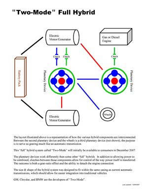

    accually that one cluch was the one i was not sure about, was thinking either there or on the other mg. either way could get the desired effect i guess. i'm not much of a mechanic.

    Based on the limited info available, it appears as though the purpose of the second PSD is to allow motor "A" (the red one, which I think is the smaller of the two) to have dual mechanical outputs... which in turn requires clutches so only one PSD is powered directly by it at any specific moment.
    With that you could possibly have the ability to use both motors to provide thrust to the wheels at the same time while in stealth... something HSD cannot actually do. Interesting, eh?
