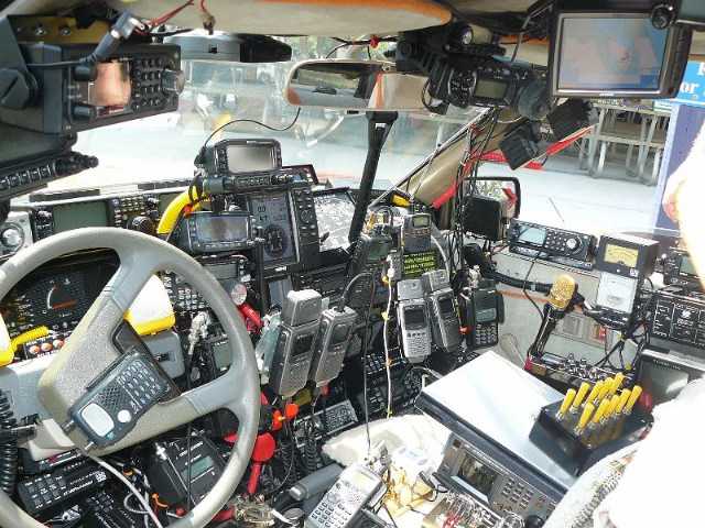

    A few ideas to work from... I wonder what his roof looks like???

    The generator he has to tow must really cut down on his mileage.

    It has one (1) big whip, and a 1 in 50 out RF splitter and mp!.....:ROFLMAO:
    Sad part I either have at one time or still own many of the items pictured here!

    Actually, I kinda had a view of an upside down centipede on the roof... Maybe even a stabilized yagi with gps controlled rotator...
    Back in high school there was this guy who ran a kilowatt mobile on 75 meters. They didn't have inverters in those days, so he used a motor/generator to power it. Antenna was a center loaded inch diameter pole about 5 feet long, then the coil, then another maybe 4 feet of whip. That thing would light up a three foot fluorescent at several feet from the antenna - no wires! The 75 meter setup was just local, but he could also adjust it for 20 meters which was useful when he drove cross country. No satellite relays, inverters, transistors ... Just ionize a path & barrel through...

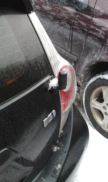

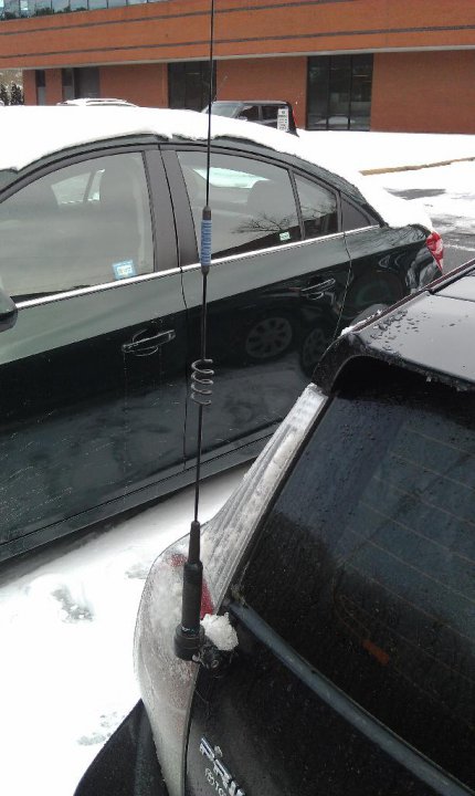

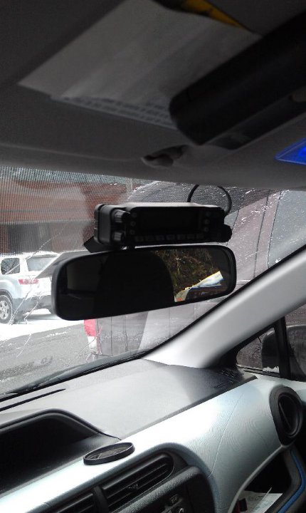

    I've got a '12 prius c-2 and installed a Yaesu ft-7800. It was new then and I couldn't bring myself to drill any roof holes so I used edge mounts on the side of the hatch. Wiring was run through the roof and side panels. I'm a bit of a nut when it comes to hiding wiring wherever possible. The control head is over the rear view mirror and the microphone is out of the console. I like the "overhead" mounting of the control head as you don't have to take your eyes from the road to make changes or adjustments and the mic has the usual remote controls built in. I took a few pictures.... Control head above the mirror.jpg Motorola speaker FT 7800 mounted to rear.jpg Control head above the mirror.jpg Motorola speaker FT 7800 mounted to rear.jpg microphone prius.jpg

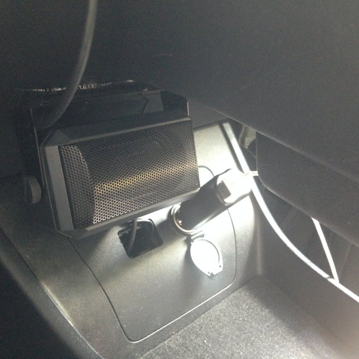

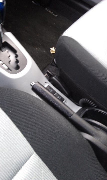

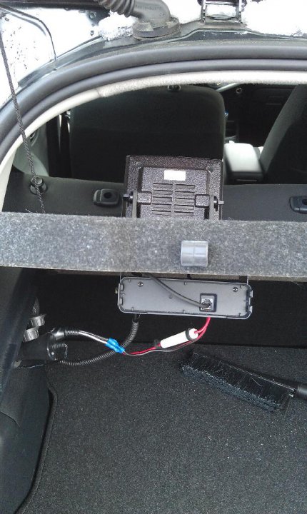

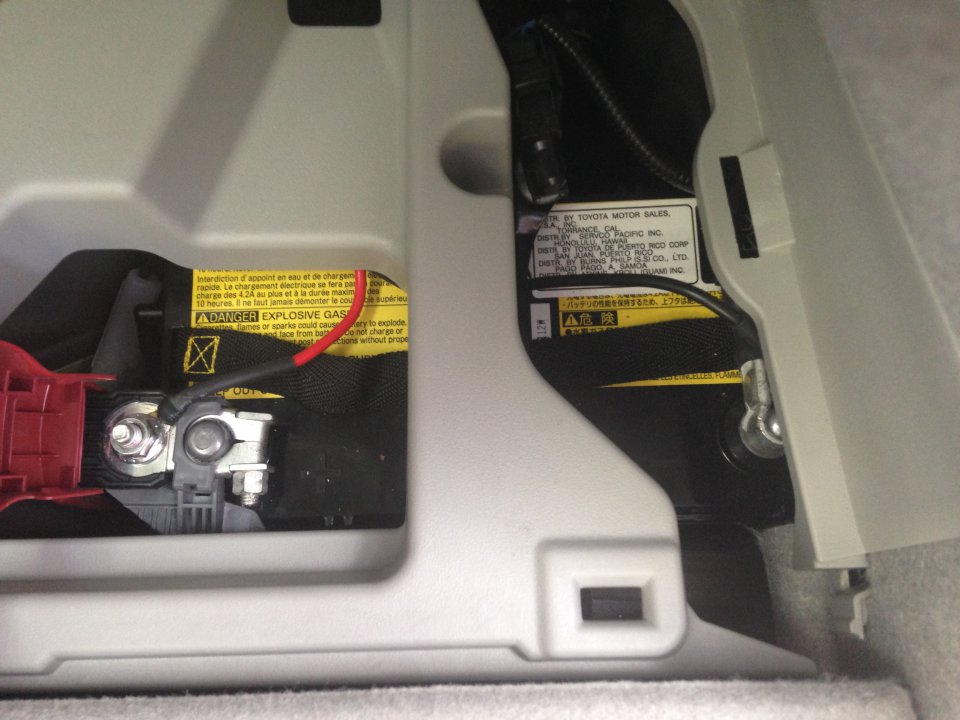

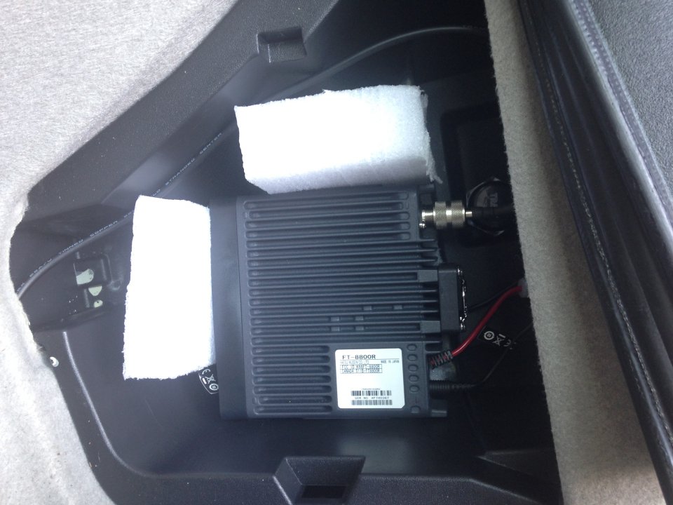

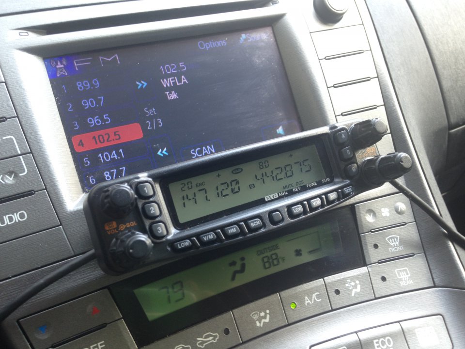

    My 2012 Pruis is very friendly for a ham radio install
    Yaesu FT-8800
    (click on pic for bigger version)
    Control Head is mounted with velcro (I like to quickly hide it or take it out when not in use)
    RoadPro RPSP-15 mounted under center console
    Feed for head and speaker exit out of unused accessory port.
    Radio guts in back left storage area which has its own access panel.
    Easy to take the radio in and out.
    The battery is located in the back right, so nice and short power run.

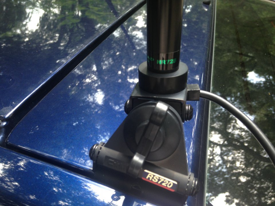

    Diamond NR72BNMO Antenna (hard to see but its only about 13" tall)
    Comet RS720 Mount
    2014-07-24 11.29.09.jpg 2014-07-24 11.23.46.jpg 2014-07-24 11.32.54.jpg 2014-07-24 11.34.20.jpg 2014-07-24 11.50.48.jpg 2014-07-24 11.50.23.jpg
    Enjoy!
    Greg
    KM4BMZ

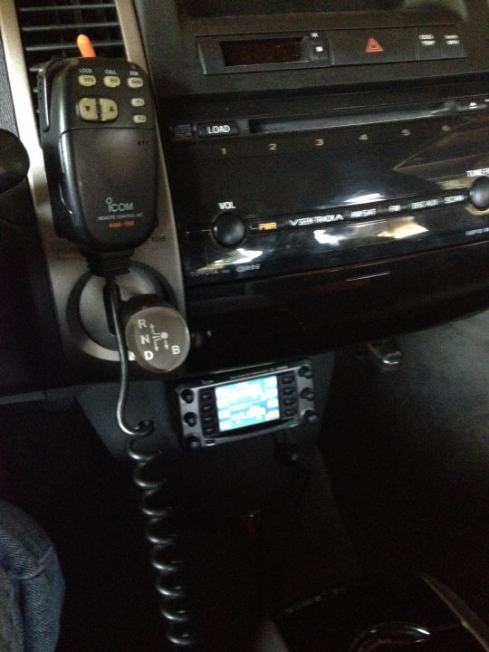

    Jonathan, KK7PW here. I recently installed my IC-2800h in my Gen2, and like the install outcome. This model requires that both control head and mic be fed directly from the radio body, so I needed to keep cable runs short.
    So, I placed the radio body under the driver seat, and mounted the control head below the dash via mounting bracket and velcro. I used a metal clothes line clip and a rubber tip for mic holder via the dash A/C vent. Power and antenna cables run along door jams to rear.
    The install is snug, clean and out of the way (XYL approved). BTW, I (with the help of my friend, N7OEP) retrofitted the control head lamp, replacing the hot running CFL lamp with bright white LEDs, so the unit runs much cooler.
    Best of luck with your install.
    73. de KK7PW
