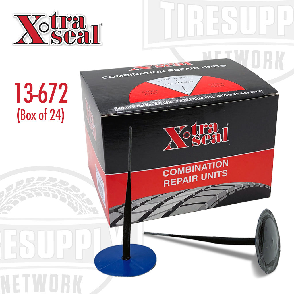

    For best safety and peace of mind, a replacement tire is the best solution for a big puncture or after multiple punctures.
    When repairing, I like a vulcanized patch which also allows inspection of the inner liner damage, which is essential with a big puncture.
    A plug alone is a temporary emergency repair. Many plugs have failed especially when used in a large hole near the sidewall. Some had big tears inside which no one inspected.
    The industry manufacturing group recommends a combination of plug for the tread side and a vulcanized patch inside.
    Tire Repair Basics | USTMA.)

    Yep, any reputable tire shop only uses a combined patch/plug.

    The tire shop said they can plug and patch the hole. I will have it done tomorrow when they have more time. @Mendel Leisk knows best.
  12. Mendel Leisk
    61,601
    42,376
    The plug style you’ve pictured above is more problematic near edge of tread, due to the disc on inside. With that plug style’s adoption by tire shop (they’re perhaps obligated to use it?), the acceptable zone has significantly narrowed. I encountered this stance about 10 years back, purchased the Blackjack kit (one of many that string-style plug repair options), DIY’d the repair, and it worked out well, no problems with two such repairs I’ve done on our Prius flats, both tires were subsequently used for close to 10 years, eventually replaced due to age.

    I took it to a different tire shop today. They said that it was too close to the sidewall and irreparable. I had enough with it, so, just took it to Downey Toyota during today's atmospheric river and had the tire replaced with the original Dunlop Enasave 01 A/S 91S (51 psi) for $192, including mounting and balancing, a two-year road-hazard warranty, and tax. Thanks to Priority Tire sending me the wrong tire (89S, 44 psi), it cost me $70 more than it would have.
  18. Gokhan
    Gokhan Senior Member
    Oct 5, 2008
    6,717
    2,672
    Paramount CA
    I was contemplating getting a tire-plug kit, but I noticed that they are only labeled for off-road use. There is probably a reason for that. Perhaps they would work as @Mendel Leisk said in most scenarios, but no tire manufacturer is recommending them, and no tire manufacture or no tire shop is allowing repairs outside the steel belt (as in my case). I wish Priority Tire had sent me the correct tire so that this would have cost me $120 instead of $190, but oh, well.
