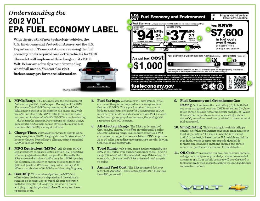

    EPA follows SAE J1711 standard that uses J2841 to get the utility factor.
    If assumption is made, it is the 33.7 kWh of electricity being equivalent to a gallon of gasoline. That assumes generating electricity is 100% efficient.

    Yes - when in fact, the more cost factors one includes that offset energy's positive btu's (energy/research for new fields - test wells - electritity for oil well pumping - shipping it around the world - energy for refining - driving it to the stations - military's energy cost to 'keep it coming' ... etc) some say those are a 1/3 profit/deduction to energy/btu return on investment. And as more and more of the old mega fields drop deaper and deaper past their peak production years, the 1/3 btu 'profit' gets you an even lower yield. Subtract all the btu's you nesd to create a gallon of gas, & your remaining btu's of energy may be less than 24kWh's. How much less? No one can say with percision, because the input values continue to change ... for ever becoming larger values.

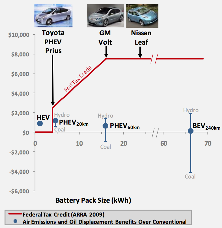

    Assumption that Well to Pump equals "Well" to Plug was made. Majority of today's electricity came from fossil fuel and a tiny fraction from renewable.
    So for majority, it should be Fossil Well -> Refinery -> Power Plant -> Plug.
    Below graph shows that if clean hydro electricity is used (best scenario), plugins can be cleaner than Regular hybrids. However, if Coal is used, the value of life cycle air emissions and oil displacement benefits will be in the negative. On average electricity, any plugin is still better than conventional non-hybrid.

    That figure is dropped from the new window stickers and isn't posted on the Volt's fueleconomy.gov entry. Likely because of the assumptions being too general.

    And because people read MPG(e) as MPG, and go buy a Prius. LOL
