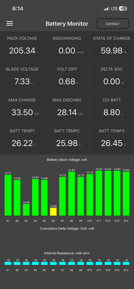

    I observed the state of charge(attached) fluctuates from 0% to 10% to 50% e.t.c Stays at 0% most times and kept display Check Hybrid System and won't ignite.

    You started with a weak hybrid battery. And it sat, slowly discharging.... certainly didn't help.
    If the 12v battery is weak also, more issues.
    The weaker cell will try to charge from the stronger cells, draining them.
    If you need to park it again, remove the safety plug, and disconnect the 12v battery.
    When you return, reconnect both.....
    Since there will be no drain from other sources, you shouldn't have an issue.
    Of course, you need to take care of that weak block. Best to replace the hybrid battery with
    a Sodium battery....
