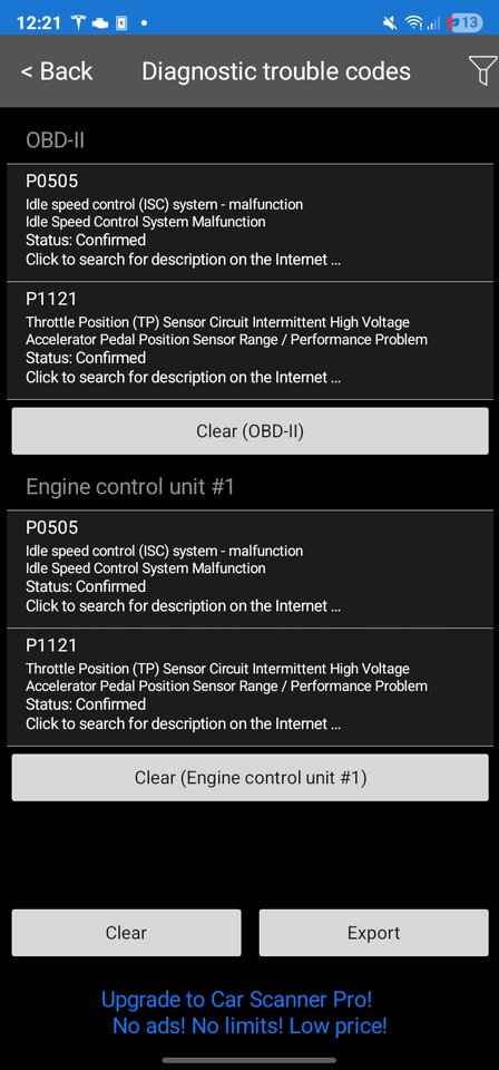

    Strangely, any OBD2 scanner I try using only gives two codes, P0505 and P1121, both related to the cooling system, but no hybrid system codes. The app I was using even mentioned that it was scanning the hybrid system but didn't find codes on it. I tried using Dr Prius but it just exists out with some error I can't quite remember, I'll be sure to screenshot it and post it next time I am near the car

    Googling "ufo light", OP is the one-and-only plausible result. Could this be something else??

    P1121 is usually the 3 way valve which determines when coolant goes into the thermos bottle. Usually the car will work OK with that not functioning. I suppose it is possible that it has broken in such a way that it leaks. This is located near the thermos and is a common part to fail. There are numerous youtube videos showing how to replace it.
    P0505 is a dirty throttle body or MAF sensor. Try cleaning the throttle body and the MAF (they are in essentially the same place), then unhook the 12V battery for 30 seconds or so to force the car to relearn. Again, youtube is your friend. Do a little research on cleaning the MAF, both the bulb and a spot below it must be cleaned. Use MAF cleaner, don't touch it with anything but spray, and it is an easy job.

    It looks like he's using the car scanner app and no telling what car he has selected like whatever it was the last time or something the codes don't even line up with the car not even for a Corolla so. He'sgotvthe app setup for his VW and Jess plugged it into Prius or such. I've done this before.
