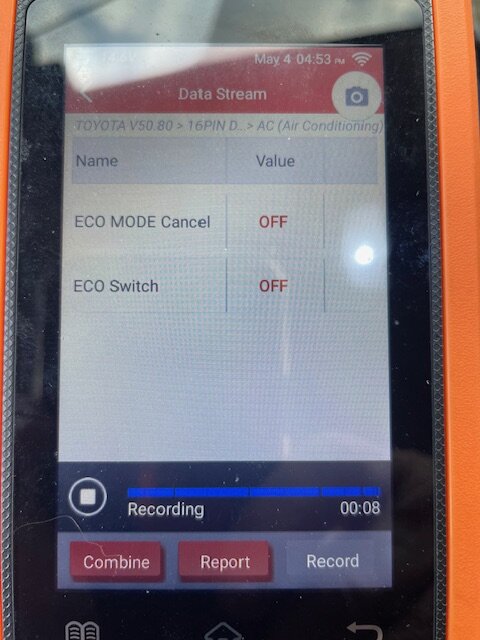

    I used my Creader to help confuse me. I got a reading of :"ECO switch: off" and "ECO MODE Cancel: off" I pressed the PWR and ECO while viewing this screen, but nothing changed. Any ideas? IMG_2709.jpeg

    If your Creader is talking to the A/C ECU and shows nothing when you press the ECO switch, that would put my first suspicion on the switch itself, or the switch panel.
    You've mentioned not seeing any perceptible effect from the ECO or PWR buttons. You haven't mentioned whether the EV button does anything. How about the hazard flashers?
    Those are all part of the same little button assembly, so that's why I ask. Also, do they light up at night when your taillights are on?
    You can swap that little button assembly in maybe 20 seconds (ok, maybe not the first time ;)), so if you had access to another one to compare with it, that might tell you something.
    The Creader "ECO Mode Cancel" PID is (I think) showing you a setting you're allowed to make that would stop ECO mode from affecting the HVAC. It's showing as off (i.e. not cancelled) so I don't think it matters here.
