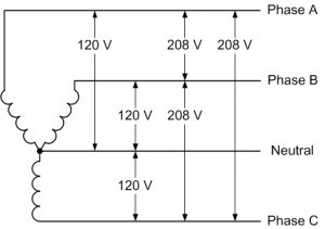

    Yeah... AC is not the easiest to grasp sometimes. Perhaps this drawing can help?
    It's a 120V (phase to neutral) 3-phase system. You get 208V by connecting between any 2 phases. Most 240V appliances will function at this lower voltage, but they may pull more current to make up for it.

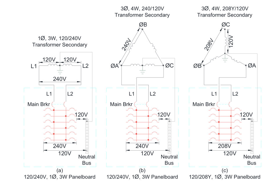

    208 vac single phase is typically available from light commercial 3 phase systems. There are many voltage levels of three phase which goes from thousands of volts in high voltage lines to 240 vac for light commercial.
    Even typical 240 vac residential comes from one leg of a higher voltage three phase provided through the utility transformer.
    These are the typical utility company secondary transformer to residential and light commercial panels as used in the US.
    However some older, slightly upscale residential neighborhoods came with three phase 4 wire 240/120 vac utility feeds and panels. One neighbor with a 2000 sqft house has three phase and only recently replaced their original GE 3 phase ac system which required no run capacitors and operated more efficiently than single phase units from that era.
